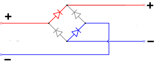

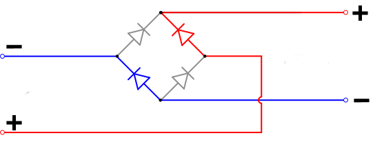

    Trying to use US SNES with PAL PSU is very bad idea, but PAL SNES won't die from DC voltage, you can use SFC, US SNES or Genesis/Megadrive PSUs w/o any problems because diode bridge will just output your DC voltage with proper polarity. In fact it's best not to go cheap and add a diode bridge to any DC-powered device, so you won't have to care about polarity at all.
