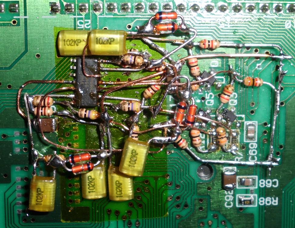

    Gonna need a schematic for this

    I dont understand electronics. I barely understand software. But what I do understand is that this should be very prone to shorts unless they've made a method to stop it.

    I was kinda joking ala old school engineer. You see a yellow film between the PCB and the solder-component bread, that's Kapton and it's a good insulator. Elsewhere he seems to rely on the green vanish that protects the PCB for basic insulation against touch-contact. The real challenge with such a construction is not to liquefy all the solder at once and unsolder everything while trying to add a component.
    Beautifullly ugly deadbug electronics that's actually like that for a reason (smallest possible distance between components in high frequency applications): http://cds.linear.com/docs/en/application-note/an47fa.pdf

    I think all schematic is given by the author of this mod, but you have to repeat scheme 3 times for each color.

    yeah, the "Geek Cred" is really annoying. I've been a video OSD nut since the 90s though and I am always striving to get the best, most crisp, video and sound from consoles. It's a fun way to learn electronics.
    I used to deadbug like that ALL the time. Variable temp irons are a must. It's a fun skill to have and I will use it still in applications with home made enclosures and such where perf board won't fit or isn't needed. deadbugging always looks scary ugly though haha.

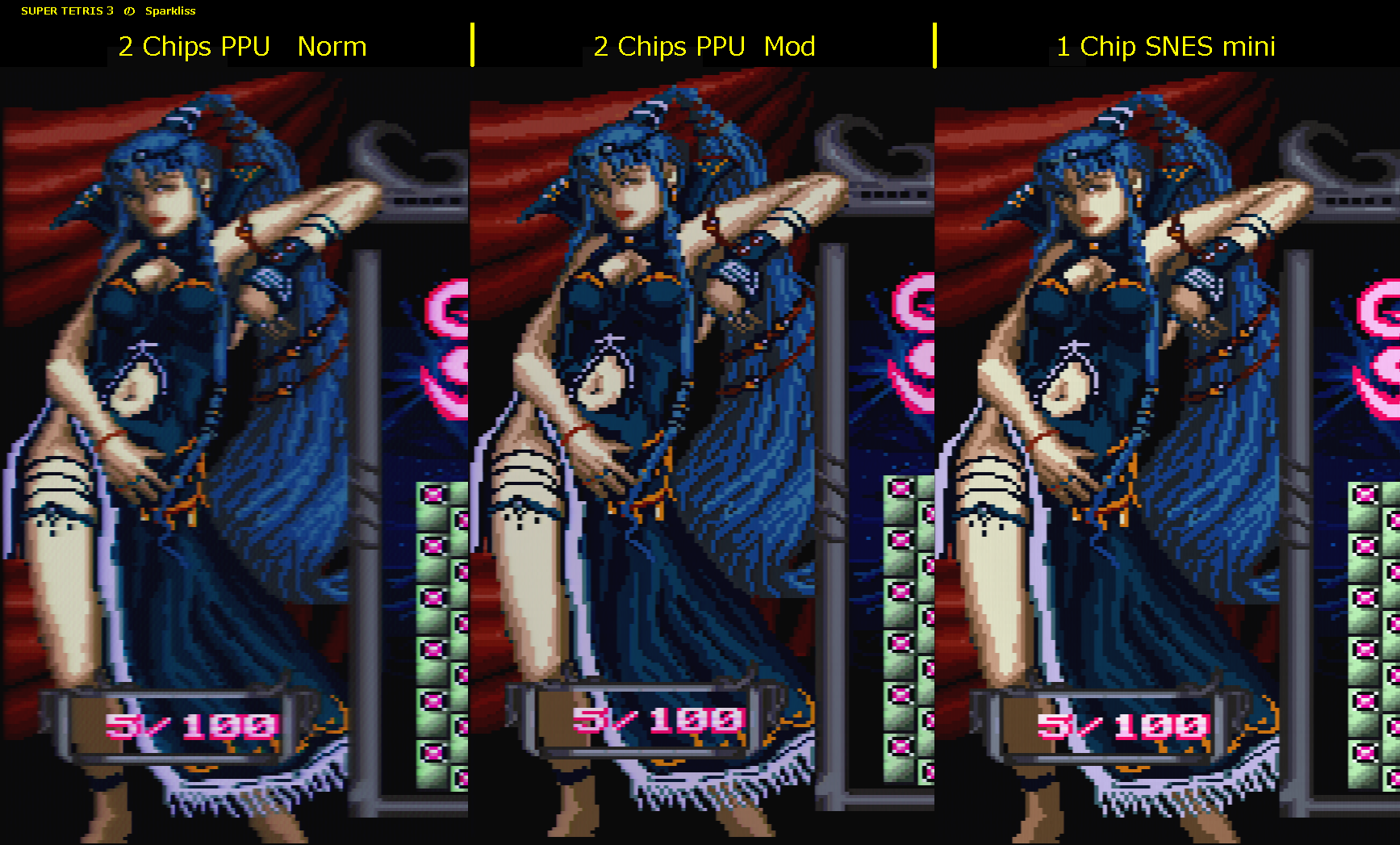

    Ew. That looks like someone digested and shat out a bowl of random components, with some candy on top for good measure... But hey, whatever works. And deadbugging rarely looks great anyways imho.
    Speaking of "it works"... The very first link in this thread is supposed to have comparison pics, but it won't work for me. Anyone happen to have a copy of those? (edit: Opening that Twatter link the second time, it now(...wtf?) shows a preview of a comparison of part of the screen, which makes it seem like a huge difference, but I'd prefer a full screen comparison if that's available anywhere?)
