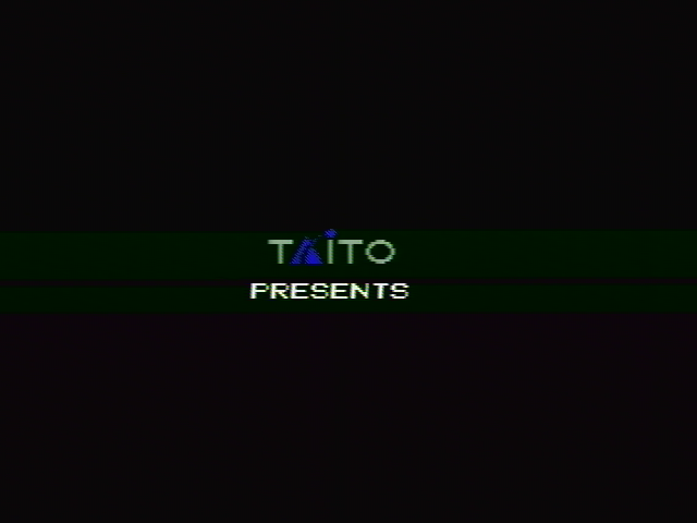

    Hi there, my SNES show green bars on a black background and i'd really to get them removed ;)
    I've searched around a lot but haven't seen anything about this. I've attached a picture to show what i meant.
    Already tried different cables (power and video), replaced the 62-pin connector and different cartridges.
    The SNES has the following text on the mainboard:
    SHVC-CPU-01
    If anyone knows a solution to this, please tell or point into the right direction :D
    Also if more information is need i'd happily share it.

    Usually green lines are associated with the power supply.
    If you've tried a known good AC adaptor then the problem could still be power-related, but on the board.

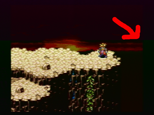

    i've attached a different picture now :) where i point the huge red arrow, there you can see a clear difference in colors (might need to zoom in a bit). Also in this video: https://www.dropbox.com/s/67u793df71c7bpp/2016-03-12 16-07-36.flv?dl=0
    At the bottom of the screen you can see it's more like purple (?) instead of the actual colors, so it looks like its not just green :(
    different question: on the mainboard at the spot that labeled with C67, there is nothing? my other SNES' do have a cap there (the big one)... Could that be an issue?
