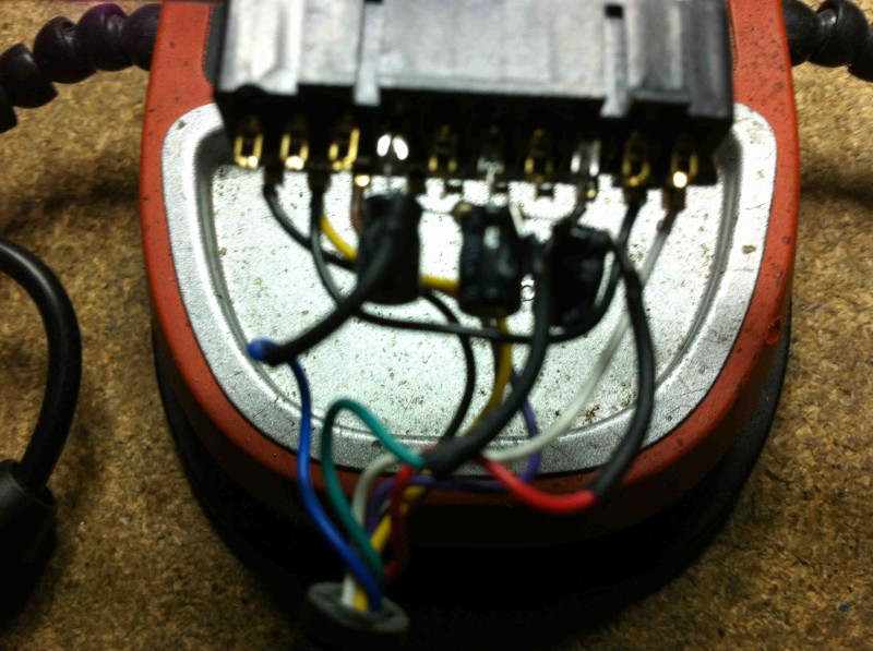

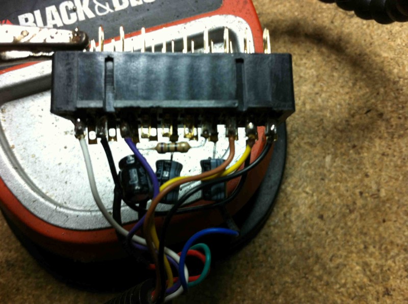

    Open the scart end and post a picture.

  5. Bad_Ad84
    1,309
    Can you take a picture looking down at the top of the connector?
    Its not clear from your picture, but from how I am seeing it - it looks quite wrong.
    top down picture would be very helpful to ensure I am not seeing it wrong.

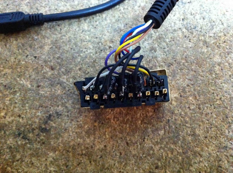

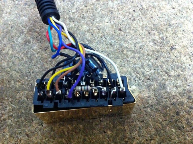

  6. fremen
    fremen Active Member
    Aug 15, 2012
    38
    Hi,
    The new pictures
    I've checked the pinout and conections and they are correct, only the purple cable is wrong (5v), I've corrected it (this correction is not in the pictures) but nothing change.

  7. Bad_Ad84
    1,309
    I mean down on the top, so the wires are sticking up towards the camera.
    But 5v being wrong will certainly cause issues, as you wont be getting the switching voltage to put the TV in RGB mode.
