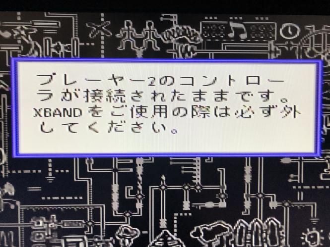

    So i have another xband modem here (japanese also) and i attempted to dump this one which i knew didnt have any good data on it and got nothing but repeating data.
    I ran a homebrew program that writes to a memory address that worked on the USA snes xband modem and unlocked the sram so it could all be seen, however it seems to have bricked the modem and it will only boot into a single dialog box of which wont go away....
  8. stevo9389
    stevo9389 Plays It Loud
    Apr 8, 2010
    309
    57
    "Blur 2's controller is still connected. Be sure to tighten when using XBAND"
    Seems like there's something lost in the translation? Does a controller have to be connected at all times?

    LOL. turns out you cant have controller 2 connected on boot...
