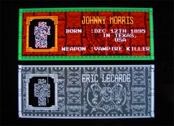

    recently got a Everdrive MD cart and finally got around giving it a test run on my japanese MD1. Of the first four games tested, two are already not running. Not the best start imagineable.
    I'm running PCB 2.3, FW 12, OS 21.

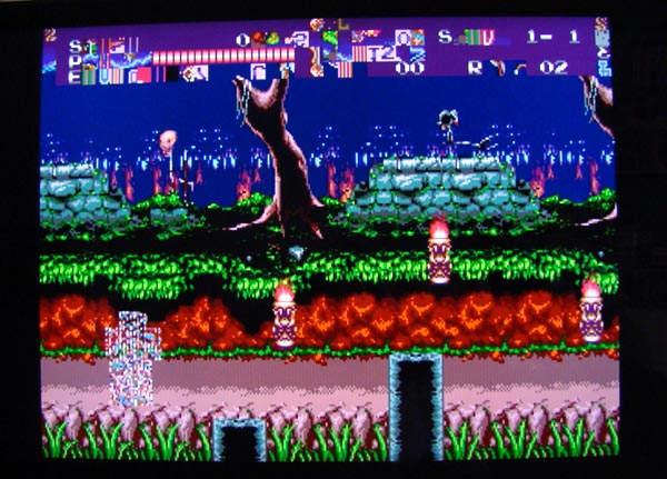

    After successfully running Alien Soldier and Thunderforce IV, I tried Snow Bros. (J) and Vampire Killer (J). Both games start, but show partially garbled graphics. Snow Bros doesn't show the title screen and once the game has started, the backgrounds show ok, but the sprites are corrupted. On Vampire Killer (japanese version of Castlevania). The Text in the game's titlescreen are garbled and once the game has started backgrounds and enemies are fine, but the player sprite is corrupted and so is the status section on top of the screen.
    I tried various setting like Hard Reset on/off and Region patch on/off and also confirmed the ROMs to be from the GoodGen 3 set. The Set includes a few alternative roms for those games and I tried all of them with the same results.
    The US version of Castlevania won't start (only shows a Konami logo), since the region patch obviously doesn't work on this game.
    If somebody would be so kind to give those two games a try - any hints on what I'm doing wrong are highly appreciated :)

    The scrambled tiles at the top of the screen could be explained by a corrupted ROM in Flash but the way the main sprite is fucked up seems to indicate console hardware issue . It seems like sprite rendering is partially disabled or at least pixel color not read properly...
    What I know is that there are some undocumented VDP test ports (mapped at $C0001C-$C0001F), that can affect the way screen (planes, sprites, etc) is rendered. I don't think Everdrive OS is writing these but maybe something else it does (or doesn't) on startup could affect the display under specific conditions and on specific models...

    @KRIKzz: the cart arrived at my friend's house today and he already gave it a try on one of his Mega Drives (a 60Hz modded PAL machine) and guess what - the Everdrive's working flawlessly !!
    So, it's my MD after all (which is still extremely weird since a few dozen original carts work fine and so do a bunch CD games I have). Anyway, thanks for the great support so far. I will now look out for a new Mega Drive and hopefully report back with good news once it has arrived.
