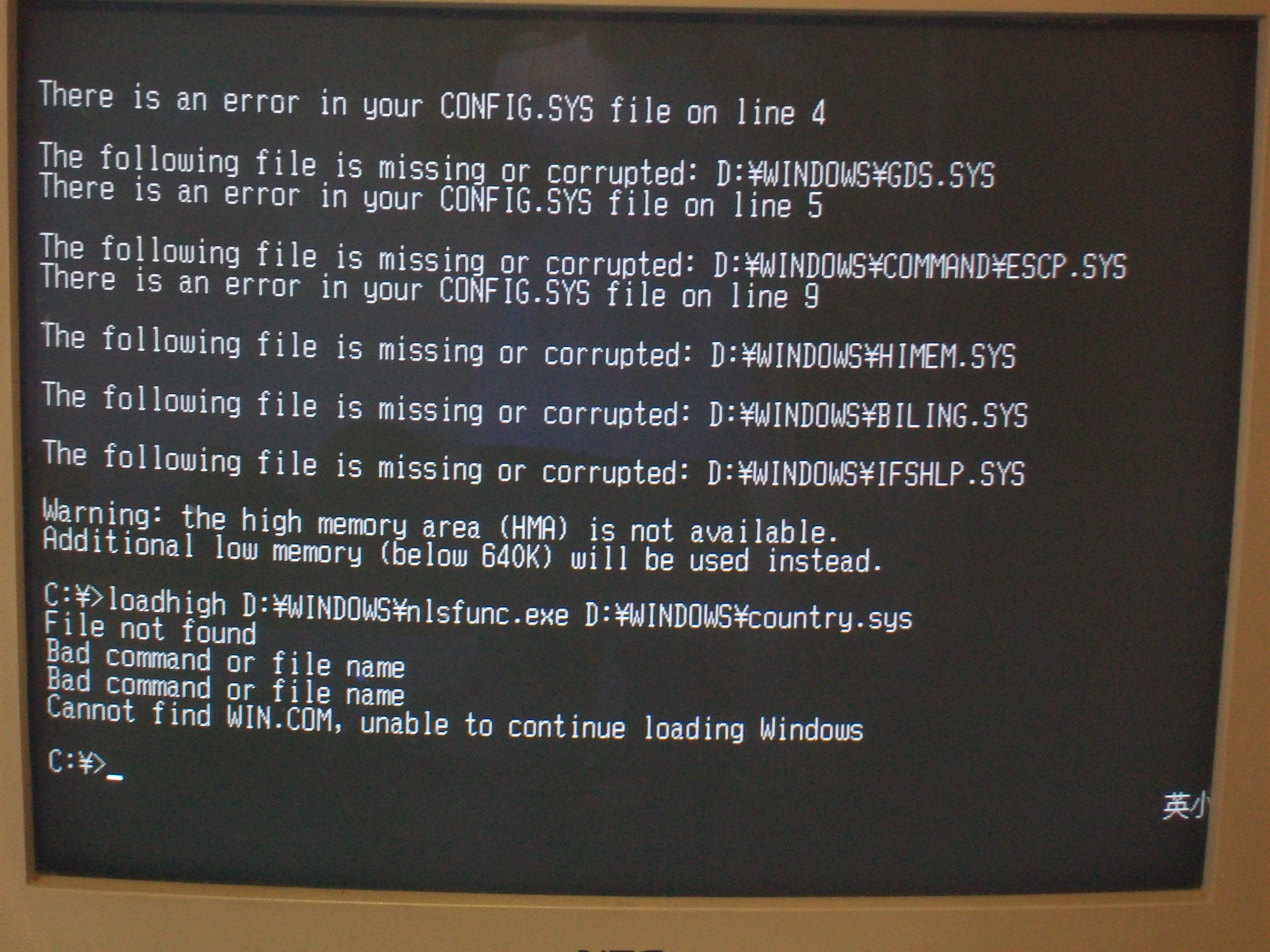

    I recently bought a FM-TOWNS II MX.It has a Seagate Barracuda ST34371N SCSI HDD inside and 70MB of RAM.
    On the HDD it has been installed WIndows95 but, sadly, it fails to boot(it gives me an error after the WIN95 logo about some missing files).

    Update:
    I was able to open the HDD image with DiskExplorer (and fmimg2.dll) and found that there are three partitions (the first is WIN95 , the 2nd and the 3rd are DATA1 and DATA2)
    I attached the autoexec.bat, the config.sys and a picture
    of the missing files. 100_3098.JPG View attachment Autoexec.bat - config.sys.zip

    Not that I know anything about the FM-TOWNS, but if the Windows directory is on the 1st partition, config.sys and autoexec.bat should point to C: instead of D:.

    Hi and thanks for reply.
    Yes, definitively the problem is in the wrong path.But usually during inizialization of HDD , the HDD itself is mapped to D:, infact if I mount the image in UNZ, Win95 boots without errors (UNZ will hang up but his a emulation issue, I presume).I think that my FM-TOWNS has some problem with the CMOS and lost the settings so now the HDD is mapped to C: instead of D:
    I know that drive names assignement are stored in the CMOS.By the way how to use the CMOSUTY.EXE utility which is on the MS-DOS disk ?
    Anyway I will try to change the path with Diskexplorer and then restore the image on the SCSI HDD.
    I wrote the MS-DOS 6.2 but I'm not able to use the EDIT command.How can be used?
