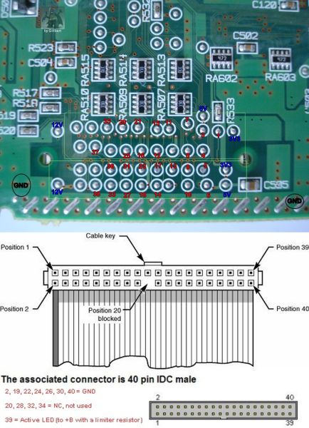

    I'm modding my Dreamcast with an internal CF-card reader, dual bios and PicoPSU.
    My goal is to have it overclocked as well using a switch.
    So far I've removed the internal PSU and replaced it with the PicoPSU kit.
    I've also installed a 2.5inch CF-card reader.
    I'll post some pictures soon, but it fits the Dreamcast perfectly, because the 2.5inch version of the reader is meant for 44-pin P-ATA (as in powered) laptops, it takes the power right from the IDE cable making the adapter less wide (because there's no external power plug).
    Pin 1-40 are the same as on the regular IDE cables, but pin 42(logic) and 43(motor) both supply 5V to power the CF-card reader.
    So I've used a 20cm 44-pin pata IDE cable which is the exact length I needed to place the reader where the the PSU used to be.
    Just strip the wires apart and you can route 5 or 6 wires trough the small round holes of the metal bottom plate.
    Also the G1 test-points feature 2 spots for 5V as well making up for pin 42 and 43 :)
    See: https://fnhack.files.wordpress.com/...ta-pins-pic-guide_zpsbzvmgvcq.jpg?w=434&h=600
    Now the first time it didn't work because I've had the jumper still set to master-mode.
    But after removing it, it worked right away and DreamShell picked up my 8GB card.
    I've tested my dump of Sonic Adventure 2 which works perfectly with DMA mode enabled.
    And the funny thing is that there's almost no loading times at all :)
    So definitely an improvement over my old sdcard reader.
