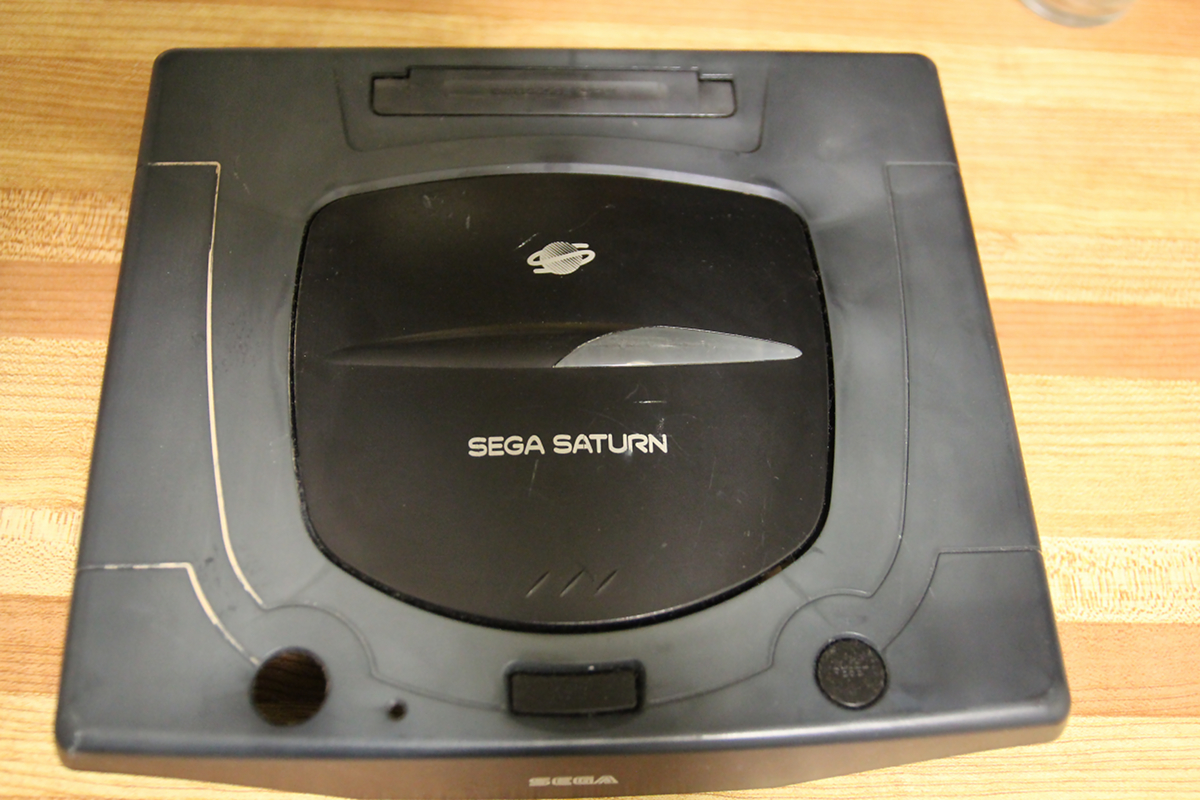

    Hi, I've bought this Saturn for really cheap price:
    But as you can see it has a lot scratches. Does any1 know any solution to eliminate those scratches?
    Console also doesn't have bezel over power/open/reset buttons, but I don't think I can get one anywhere :(

    Novus do a range of polishes, Novus 2 in particular I use a lot on pinball machines and it works well but I don't think you'll be able to 'buff out' scratches that deep!

    the below is the result of me putting Novus 3 on the shell and leaving it for some time , after that i put it in boiling hot water and scrubbed the Novus 3 off.............
    i had to buy a whole new top shell from someone i know in the US

    Always test on a small area first, but tbh I am surprised. Never had any problems like that with Novus 2. How long did you leave it on there for?

    its been about 2-3 years since i did that i dont remember exactly , im thinking 15 -25 mins and then washed it off in the sink

    You aren't really supposed to leave Novus 1-3 on, it's more of a polishing paste afaik. I'm guessing it was washing it in the sink that did it though.

    the water i used to wash off the Novus 3 was boiled in a kettle and put in the sink , this is the second thread of mentioned my experiences with Novus 3 and how not to use it.................

    aah that makes sense. I'm almost certain that it was the boiling water and not the Novus 3 that caused the discolouration.
  13. retro
    I really wouldn't bother. It's in a state and it's not the sort of material that should be polished - polish is for a gloss finish, which a Saturn doesn't have. Use it as it is, or customize it (paint it or something).
    I'd say it was a combination of the two - the instructions were not read. I don't think NOVUS No. 3 (for heavy scratches) was the right product in the first place (especially as it needs NOVUS No. 2 for finishing) and it states that it's not for use on coated plastics. Anyway, it's a polish - you polish it on, you don't leave it. And you then remove ALL polish with a cloth - not water. Just like polishing a car, or a table. I really don't understand why you'd think you'd need to pour boiling water on it.

    I haven't had any luck with this ever, I think if you tried to polish the scratches out in any way you'd end up with glossy patches and it would look a mess.
    Best you can do is magic eraser it (they are slightly abrasive, so they DO help restore the finish but don't go too crazy) followed by a wipe down with WD40.
