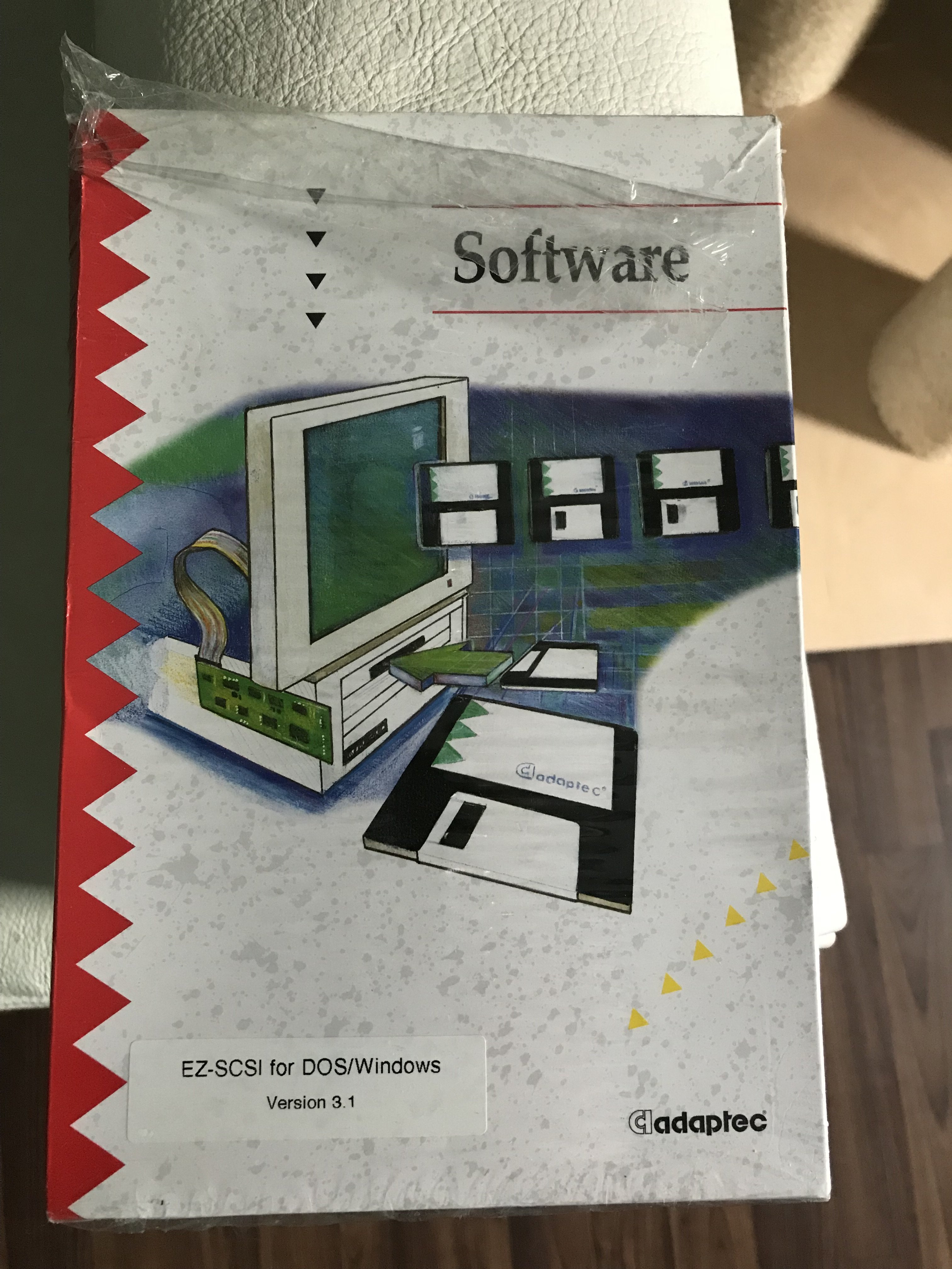

    What version of cd gen do you use?
    I use the CDU-921S with an AHA-294X PCI controller on Win98SE. The Drive shown as CDU948S but CD-Tool 0.2 and CD/DVD Gen 2.0 work without any problem.
    Have you installed the EZ-SCSI Driver and Software V3.1 ?

    I'm not familiar with that software I'll give that a go I will have to use 98 for that it seems. Software V3.1??
    I'm referring to the PS2 CD/DVD Gen to clarify, I will give removing the drivers a go. The PDF helps a lot I haven't even heard of SCSI select so this is all new to me.

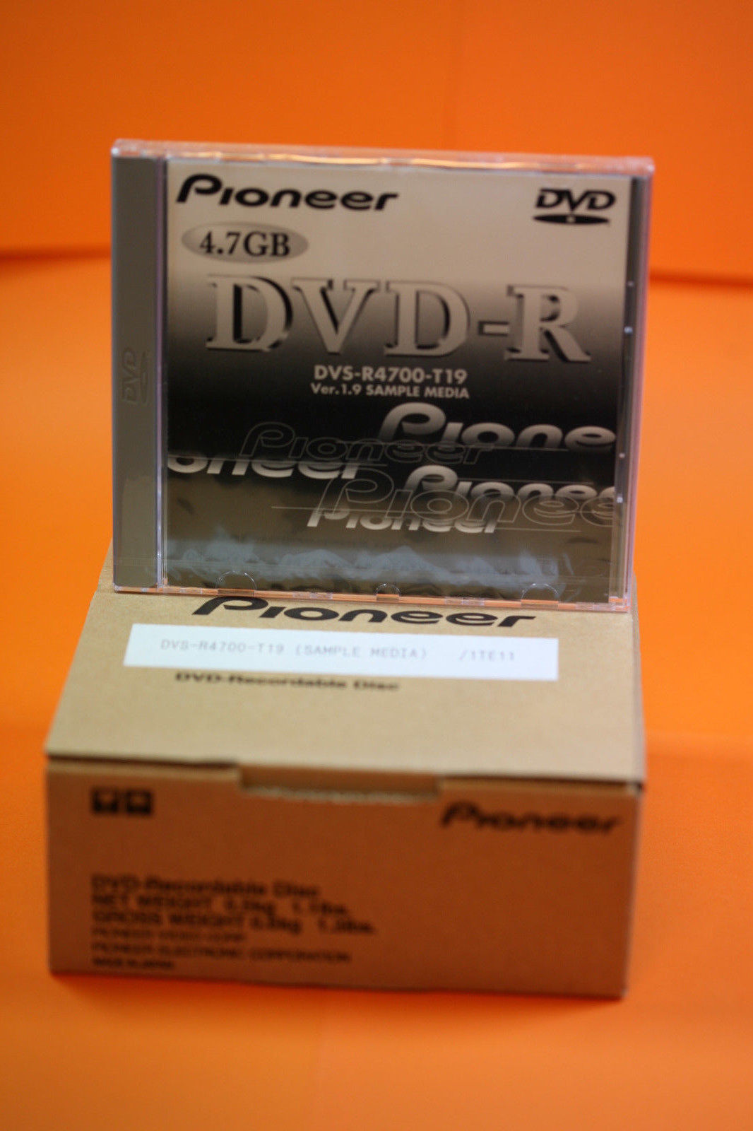

    Pioneer DVR-S201
    DVS-V3950S-B, DVS-VP3950S-B, DVS-R4700-T19
    onza120 likes this.
