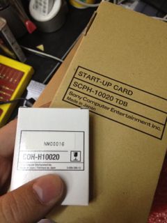

  8. HI_Ricky
    HI_Ricky Intrepid Member
    Jun 7, 2007
    650
    187
    final, i got it too :)
