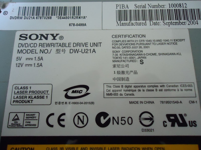

  20. l_oliveira
    l_oliveira Officer at Arms
    Nov 24, 2007
    3,879
    245
    KWS200a will be found on DESR-5000/5100/7000/7100. All units with XPD-001 motherboard.
    Apparently some Japanese website mentions these SONY drives as potential source of parts (KWS200a)
    http://sony.storagesupport.com/product/104 (DRU510A)
    DW-U15A (the same drive but with different firmware, used internally on some tabletop SONY DVR units)
