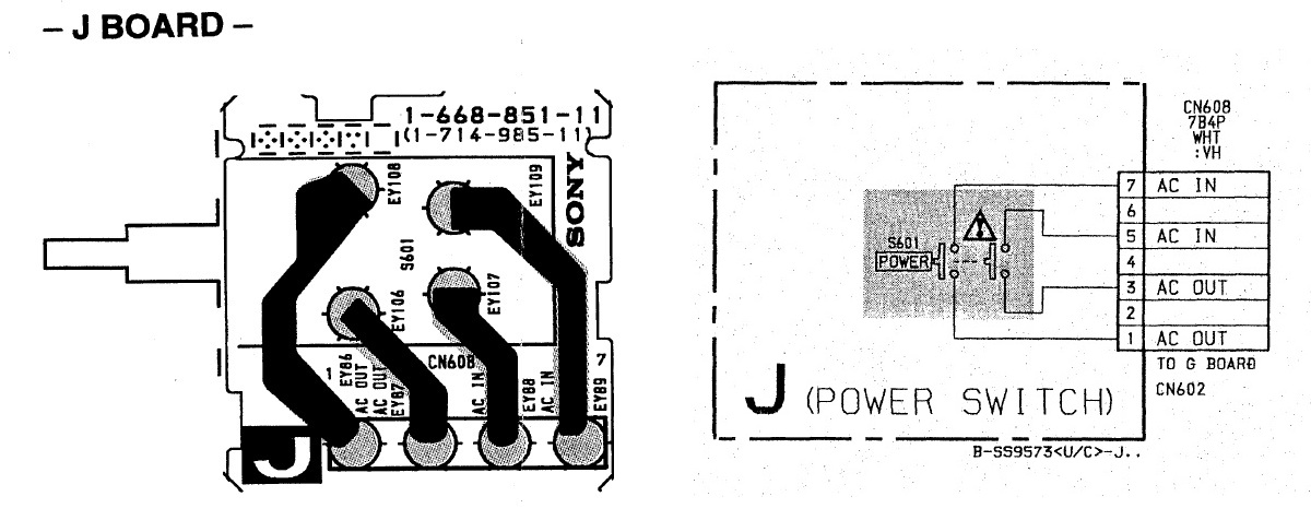

    The switch is on the J board which connects to the G board. In theory, you could short the two poles either on the J board or the G board and remove the J board if it is no longer firmly secured (should be two outer poles together and two inner poles together, but whoever does it needs to be certain), but remember it's mains so use the correctly rated and insulated materials.
    You can't get the J board assembly any more, but the board itself is probably OK. You might be lucky and it's just come loose, but it could well be that the screw mounts have snapped. If the switch has gone but the board is OK, you may or may not find a suitable replacement.

    worst case OP would have to have a different panel mount switch installed, which would not look stock but at least work..
    I don't own any PVM but I'm guessing the j board connects directly to another PCB and doesn't use a flex like some other equipment..

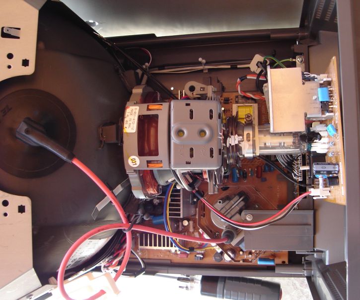

    As mentioned CRTs around the Flyback transformer have high voltage, even when unplugged. Keep clear of that when you pop the cover. That power switch can be an easy fix, just be very wary what not to touch. You can discharge the Flyback, but that has its own safety risks in addition to blowing the decades old capacitors.
    I have soldered in new chips on the D Board of my WEGA without that risky discharge, just kept clear of the Flyback. Also pulled the covers off all my CRTs including TVs, and PVMs for a dustout. Be very careful and it can be done.

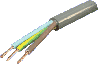

  9. retro
    Oh, what is it with Aussies using weird English this week? :p
    That's a 3 core mains cable lol.
    As per what I said and the diagram, the J board connects to the G board. The G board is the PSU. I'm fairly sure from the diagram it's just a connector to the board, but I don't remember going in this model so I can't be sure. Sony do weird things sometimes!
  10. LeHaM
    LeHaM Site Soldier
    May 5, 2013
    2,634
    292
    Plenty on British electricians call them flex cables :p
