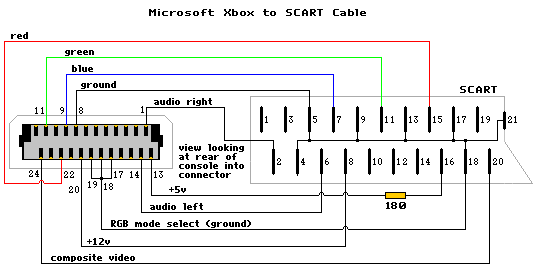

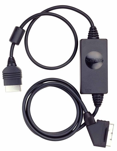

    Hey. I'm looking for a schematic of how to output a stereo in this cable in the picture below.

    It should already have stereo audio out.
    Original Xbox to SCART video cable pinout:
    Xbox AVIP Pinout:
    NOTE: Pin numbering inconsistency between these two diagrams. The first numbers the top row of the AVIP connector as pins 1-12 and the bottom row as pins 13-24 while the second all the even pins on the top row and the odd pins on the bottom row.
    The first diagram's Xbox connector is the second's XBOX AVIP Plug - Back View.
