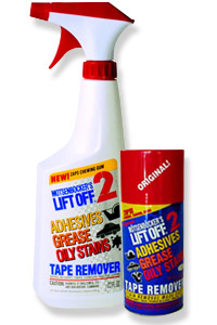

    To get rid of the multiple gamestop labels, aerosol liftoff 2 works pretty well. Works great on DVD cases and carts. Eats up brittle plastic such as jewel cases though. Most hardware and paint stores carry this.
