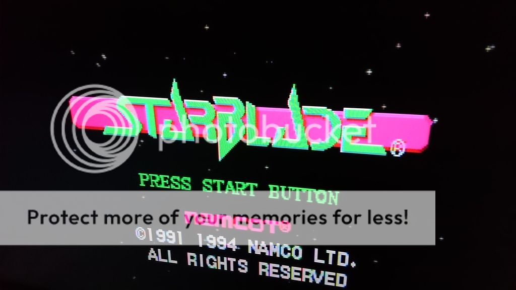

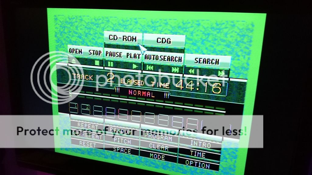

    So, recently my Wondermega Mk1 has been producing some very odd colours.
    Upon switching on the machine it can look normal however within a few minutes the red from the image seems to drop out however it will return after leaving the machine on for 30 minutes. I'm running the picture from the S-Video port.
    Take a look below.
    Colour after 5 minutes of use
    Returns to normal after 30 minutes
    In game it's the same. After 5 minutes of use
    After leaving the game running for 30 minutes
    I hope it's not time to replace the caps but it sure looks that way.

    Man that looks like a ball ache to disassemble. Definitely looks like a cap issue. As the cap 'warms' up it settles down. It seems to be the 'Blue' channel that's playing up as you have both 'red' and 'green' in the beginning. As you are getting this on S-Video, it suggest maybe the problem is happening before the RGB is processed into Y/C at the Sony CXA1145 encoder. Yakumo, do you have pictures of your Wondermega board specifically around the Sony encoder chip?
