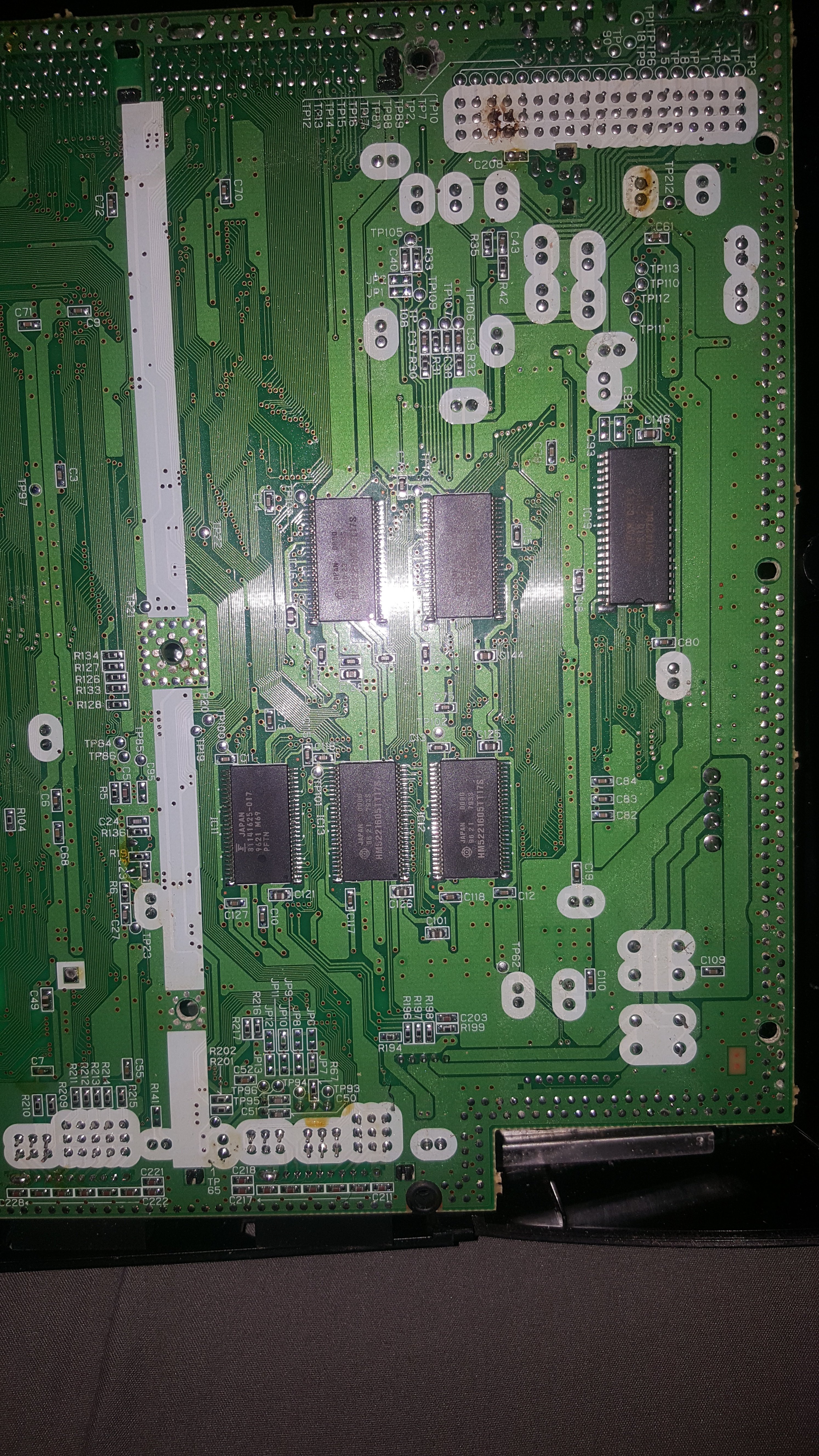

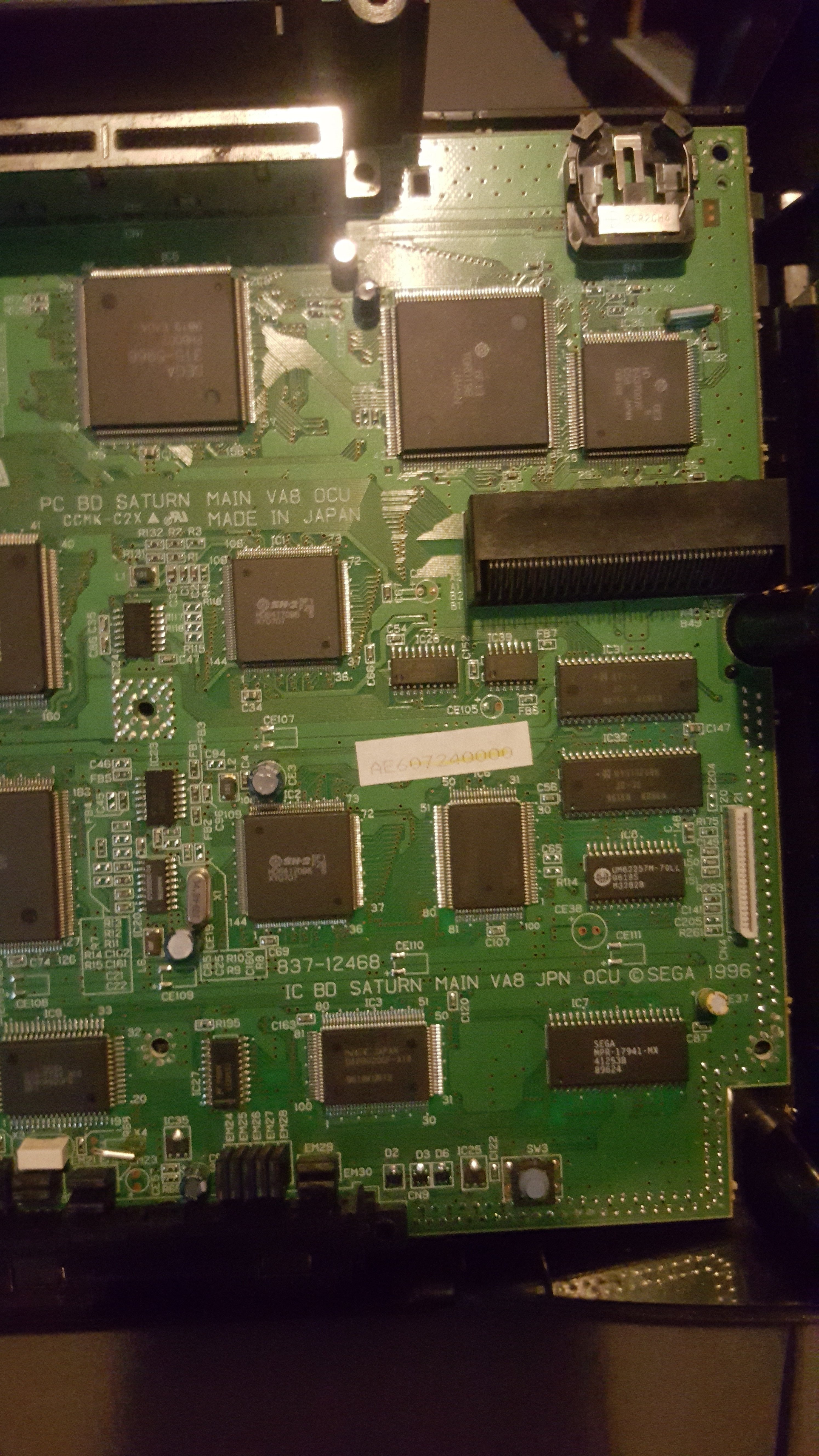

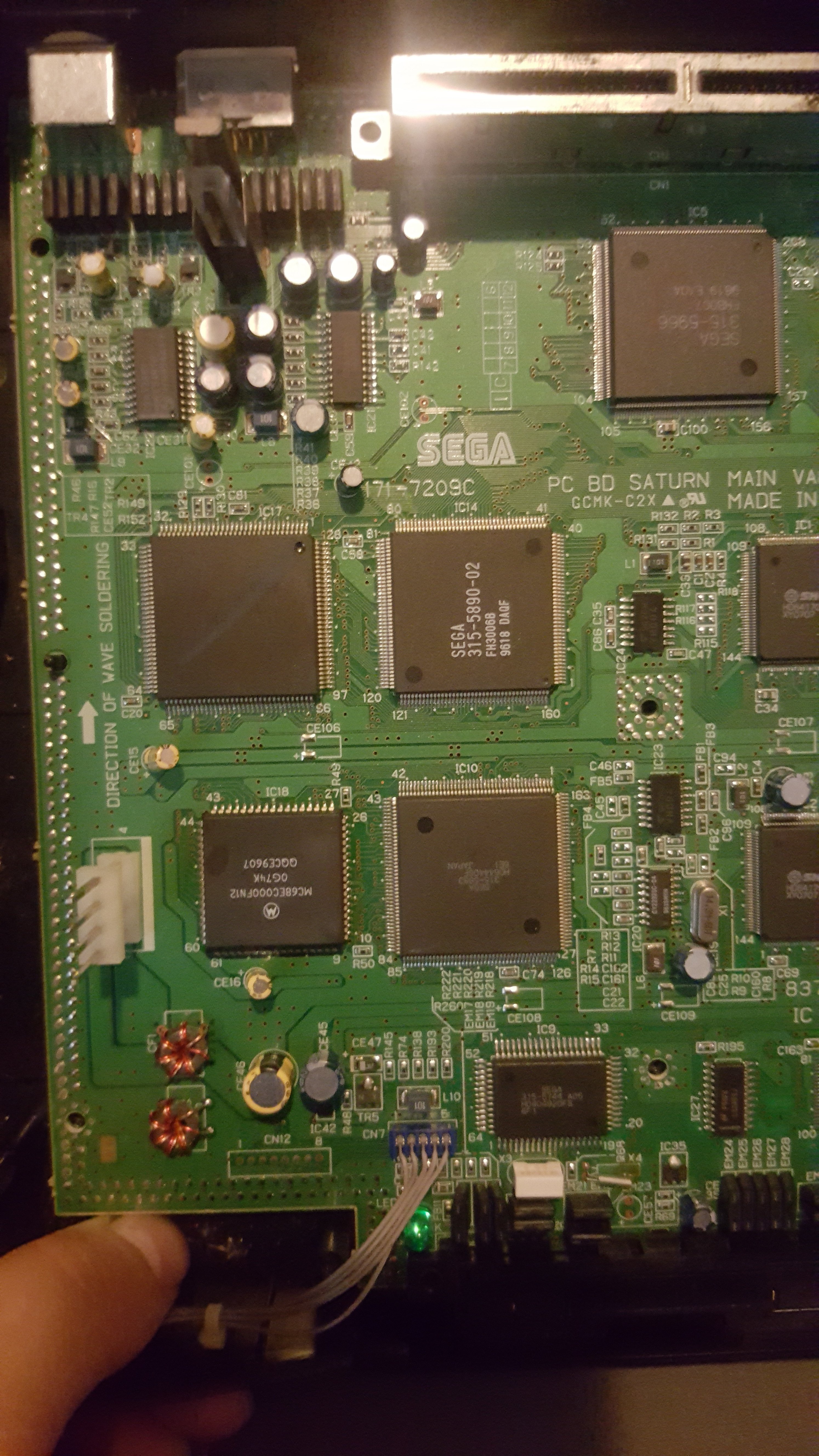

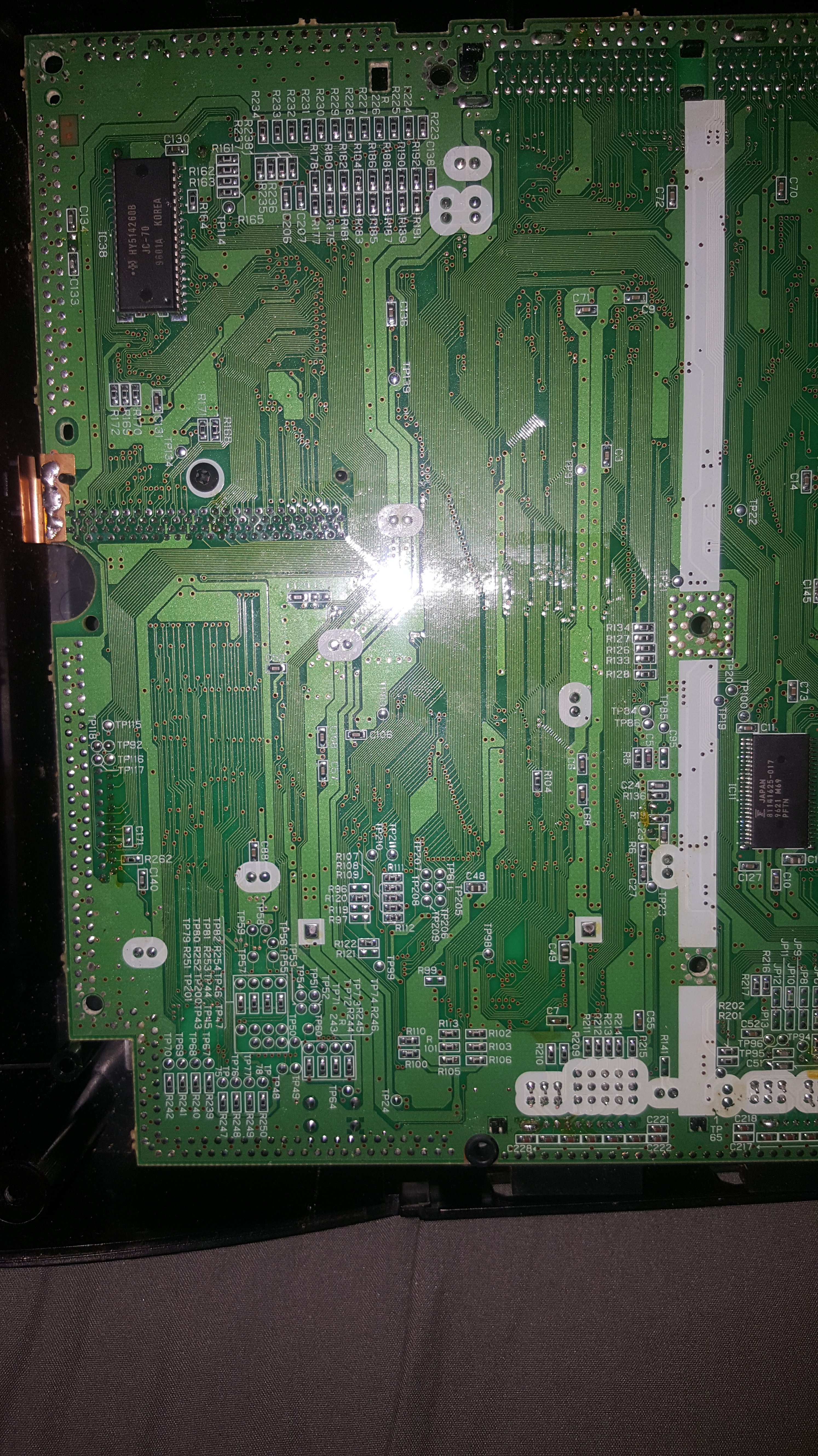

    20170728_130746.jpg 20170728_130751.jpg 20170728_130041.jpg 20170728_130044.jpg Here are pictures of the board for anyone who can spot anything weird.
    Thanks for the response, but I'm wondering about the board not the drive.
    Unless I'm mistaken(I might be, I really don't know) the drive won't cause graphical issues such as missing graphics on the splash screen and crashes. It came with a JVC drive installed, so I assume it was the default. Tried a Sanyo for kicks and no dice. Don't have any other 21pin drives. It had no bracket for a trap board, so I even tried my phantom chip and nothing.
    As far as I know the only graphical issues caused by the drive not being read properly is that the squares on the sides of the menu screen turn into large red blobs.
  8. Yakumo
    I'd be interested in seeing the main CD player screen. Sounds to be different.
  9. miloxydia
    miloxydia Spirited Member
    Oct 14, 2011
    105
    34
    The thing is this particular board doesn't boot past the splash screen.
    This bit here is something I've experienced on other saturns.
    The board flashes the Saturn Logo icon while booting, the icon disappears as the "SEGA SATURN" logo appears though.
    It will boot past there into a game and while I don't notice any graphical errors in game, I haven't found a game that will actually go into gameplay (it crashes in the menus always).
  10. Bad_Ad84
    1,309
    Fire up Yabause, disable parts of the rendering until you (hopefully) get same issue you have.
    This will help track down the issue (VDP1, VDP2, etc). then you can look for lifted legs or trace damage in the area.
    Edit:
    Ignore me, you said there ISNT graphic corruption. Its been a long day.
