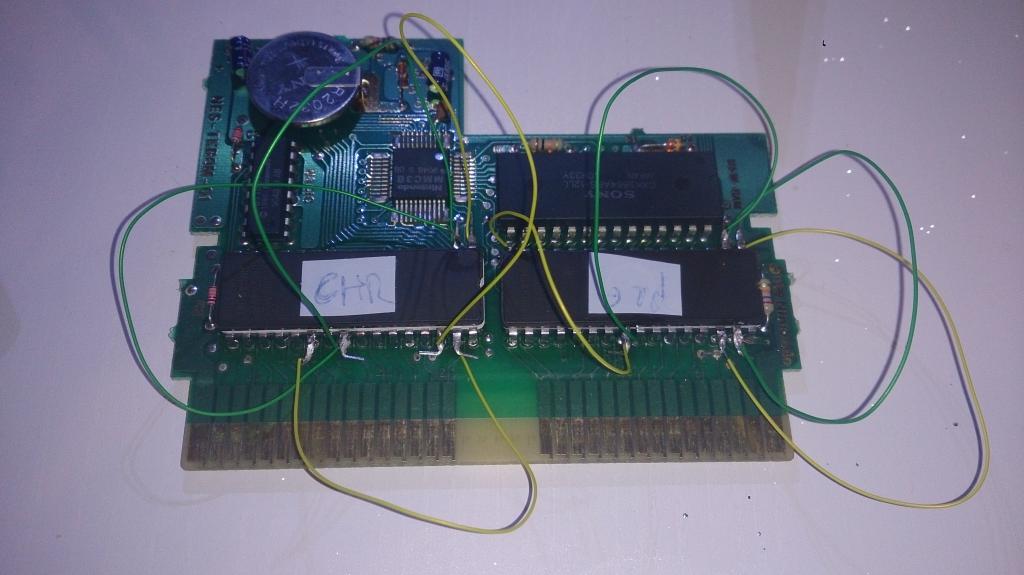

    but i have created my first repro (earthbound zero) using some online tutorials but i only get a white screen when i put it in my nes and yes i have tryed multiple nes systems all the same result.
    i have used a copy of deja vu for the nes as donor cart and removed the old chips using a de-soldering iron they came of very clean.
    then i programmed the eeproms (27C010) as PRG and CHR and soldered the wires to the clean board then the eeproms and after that the wires to the eeproms.
    i mostly used callenbrown.com with his advanced MMC3 repro guide and i also used this table for the wiring
    TKROM & TSROM (mapper 4):
    PRG socket:
    Bend up pins 1, 2, 24, 30 and 31 (or cut tracks 2, 24, 30 and 31)
    Solder pin 2 to hole 24 (A16)
    Solder pin 24 to GND (OE)
    Solder pin 30 to hole 1 (A17)
    Solder pin 31 to hole 2 (A18)
    CHR socket:
    Bend up pins 1, 2, 22, 24, 30, 31 (or cut tracks 2, 22, 24 and 30)
    Solder pin 22 to hole 31 (CE or CHR /A13)
    Solder pin 24 to hole 2 (OE or CHR /RD)
    here is the picture of the completed repro i wanted to clean it up but i thought i test it first before cleaning it up i,am using kynar wire to connect everything.
    any help would be appreciated!!!
