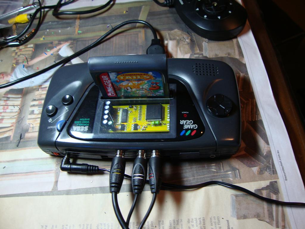

    You can always mod a game gear to play on your TV, just be aware it won't display at full size. For example if you have a 34cm TV, the image will be around the 20cm or so mark.
    Here is mine I have done.

    I used a video board (the one that is shown through the screen) from a chap on smspower forums. His user name is Viletim. Here is the link for you http://www.smspower.org/forums/viewtopic.php?t=11931 .
    The video board can output RGB, S-video and composite. Composite was good enough for me, so I just went with that.
    I had a GG that had a dead screen, so I removed that and fitted the video board in it's place. I removed the cart slot and relocated that through the GG outer screen so it is now a "top loader". It required that I lengthen the back row of cart slot pins, not really to hard. With this though, I can't play SMS games anymore, bbuuuttttt that doesn't matter as I have a fairly modifed SMS2 for that (50/60Hz & language switch, pause on control pad, on light built into the power switch <refer guide on mmmonkey website>, FM sound board <also from Viletim>, RGB, S-video and composite out).
    I used a controller port from a dead MD2 and wired up controller port 1 to the existing GG controller points (the GG buttons sytill work). I wired up the 2 player port via the EXT port on the GG, here is a link for that http://www.smspower.org/forums/viewtopic.php?t=12065&highlight=game+gear++player . I also added the pause mod trick from the SMS into this so I can use my modified SMS control pad with the pause button on it.
    I think that is about it:thumbsup:
