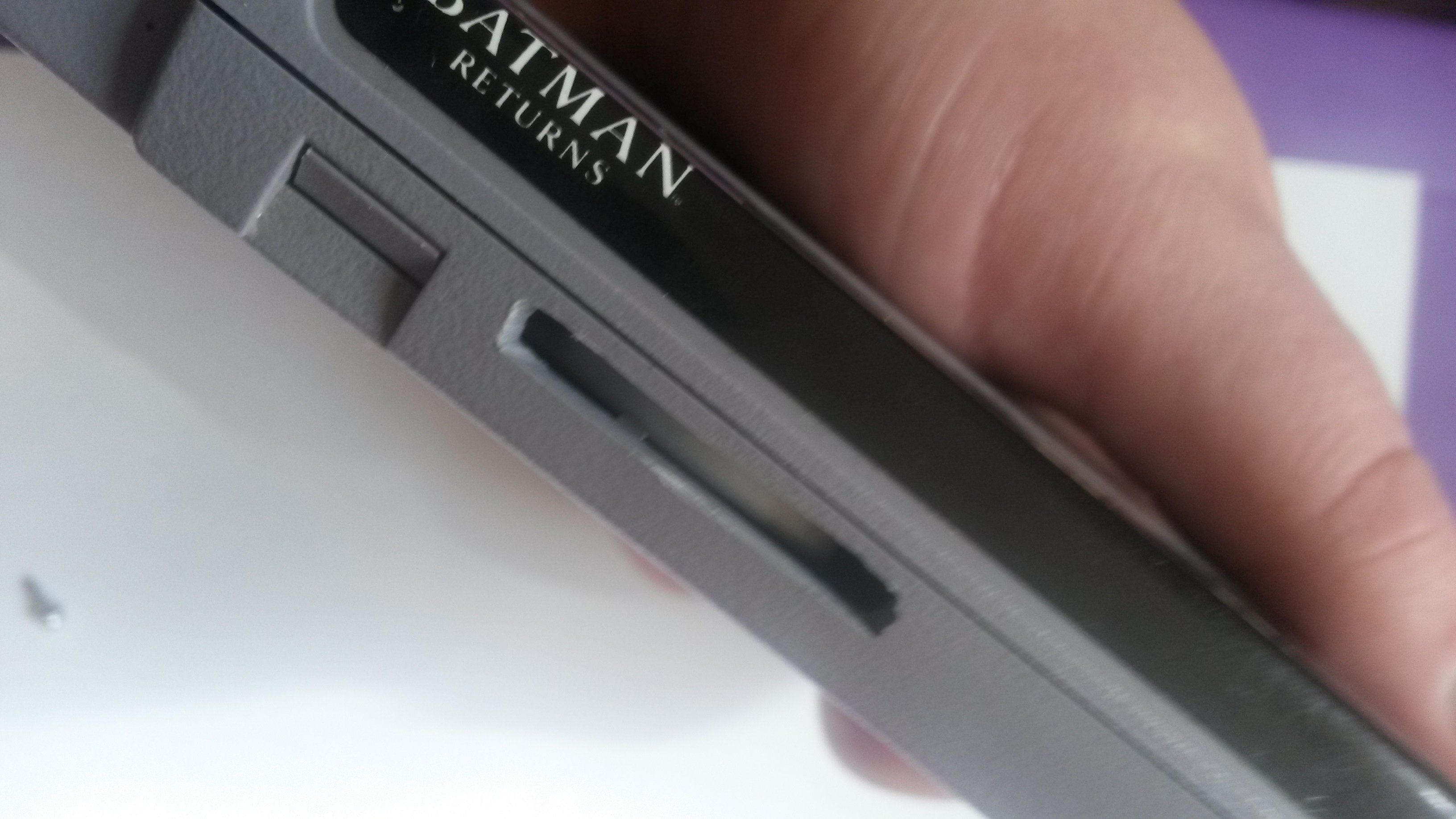

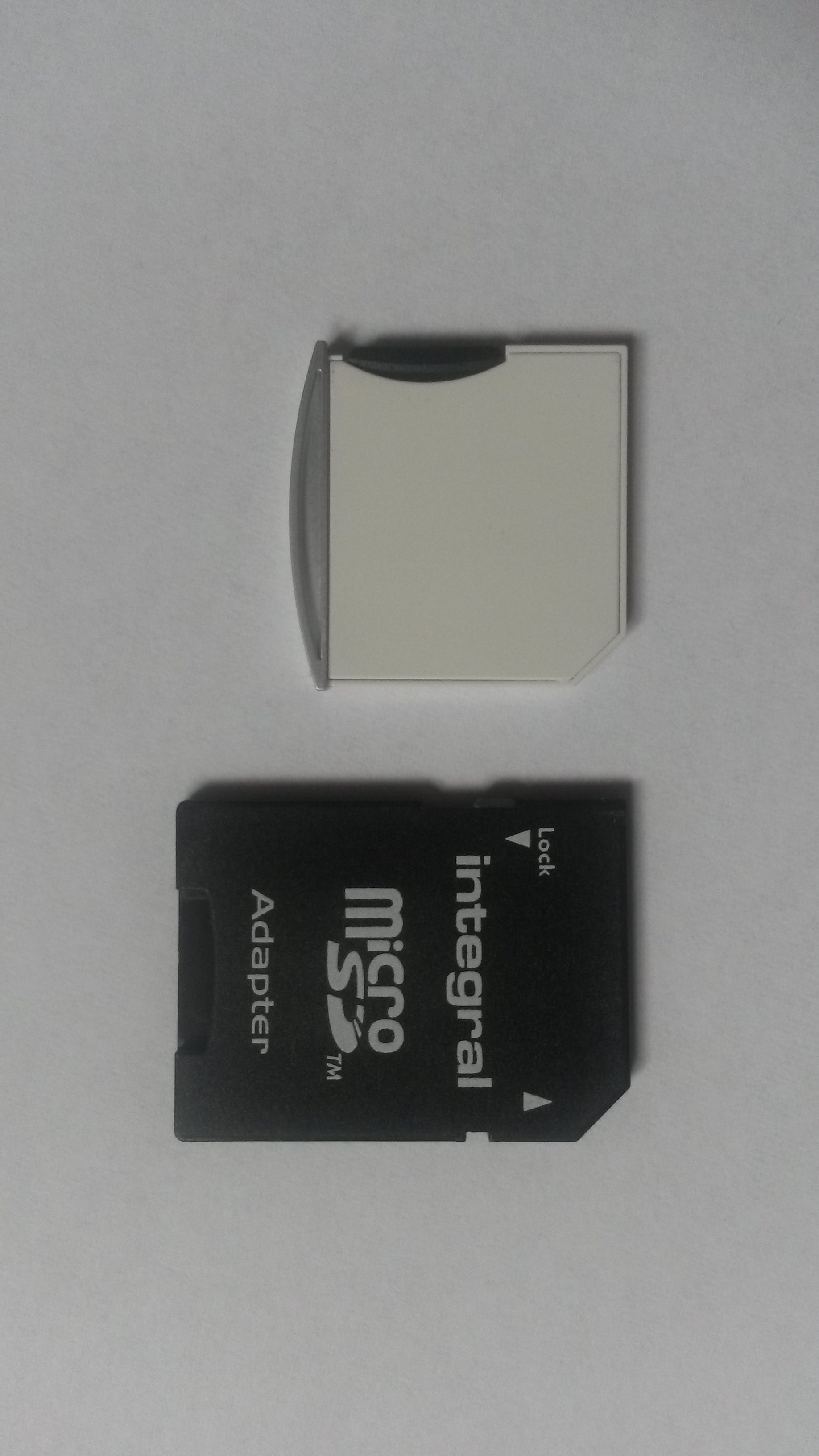

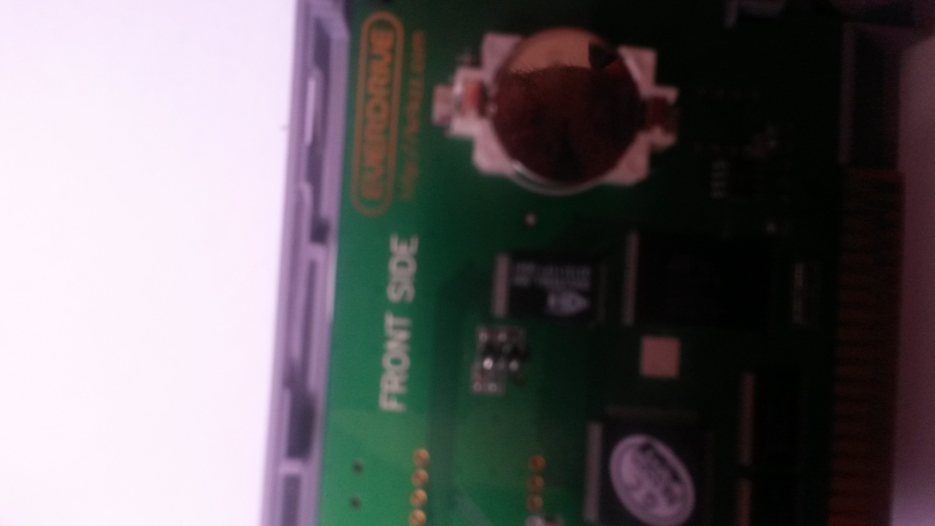

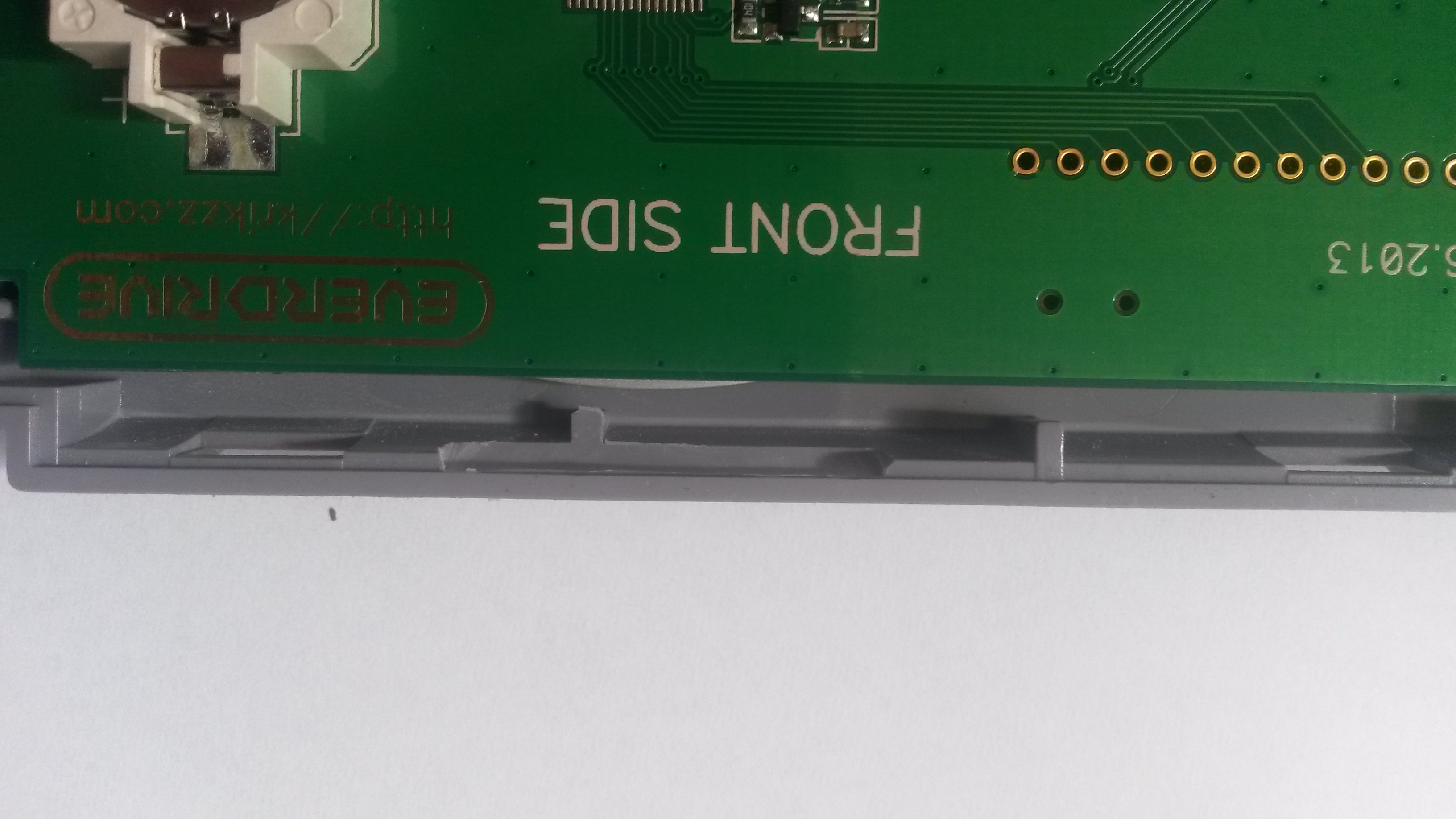

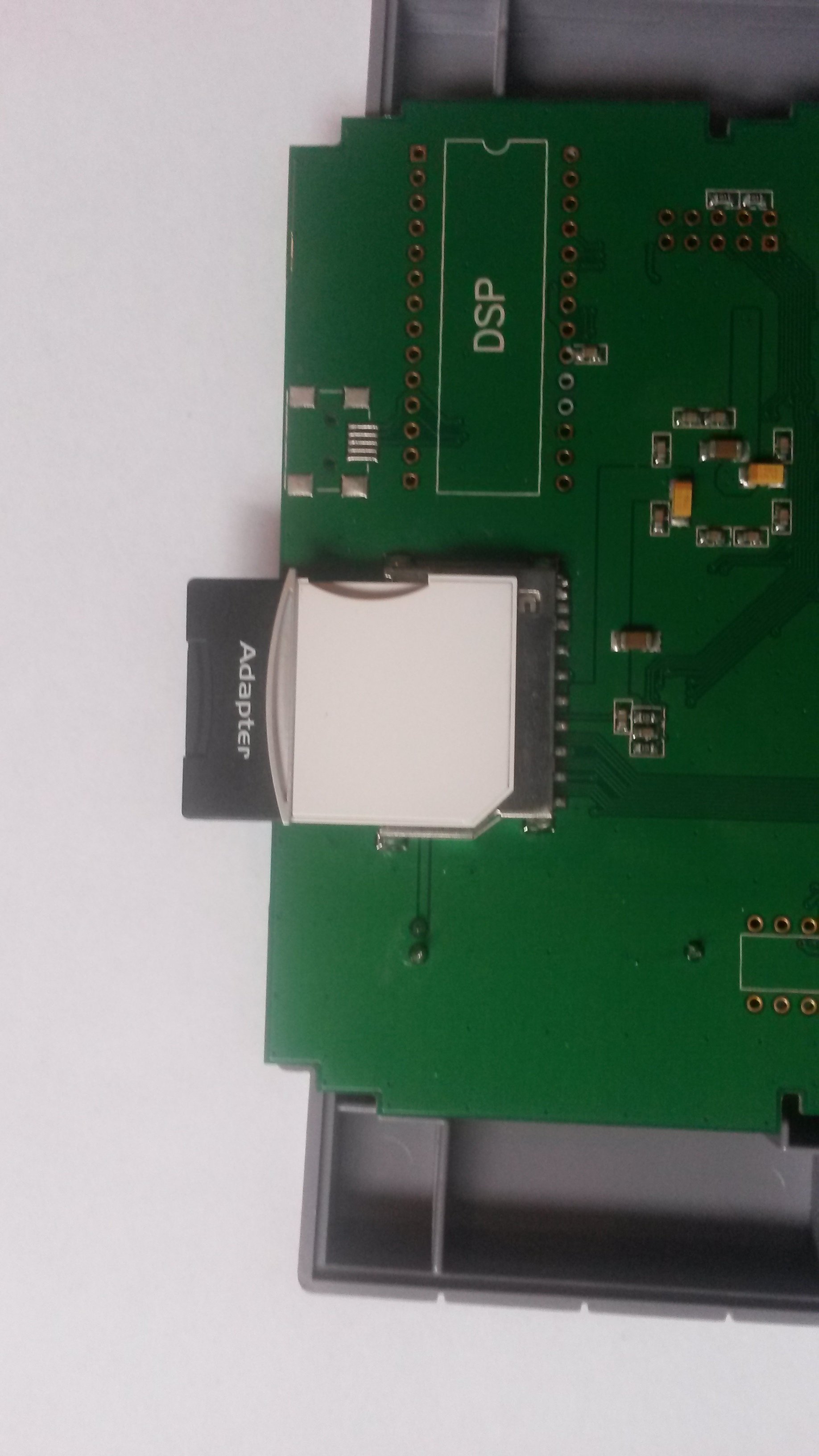

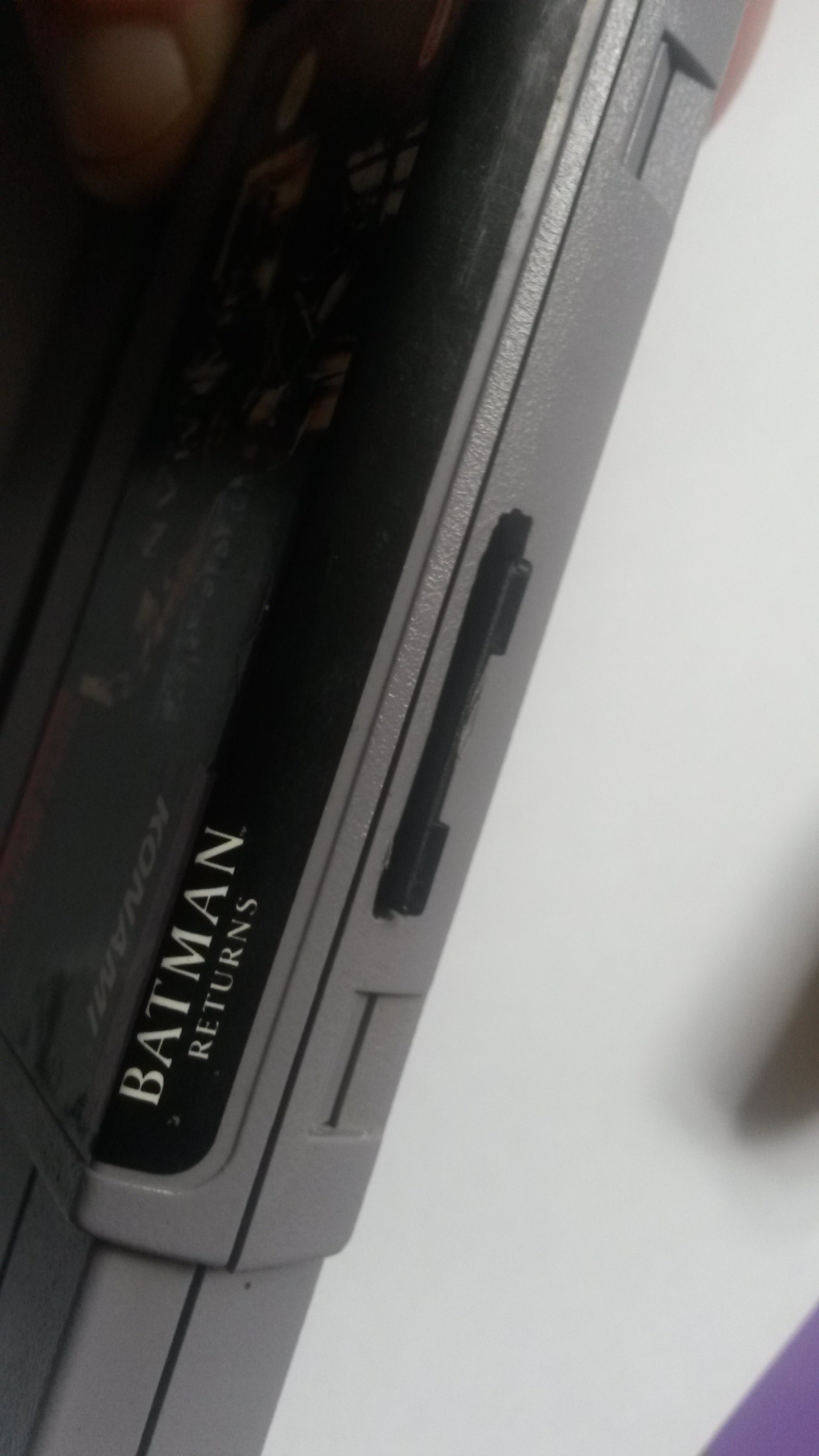

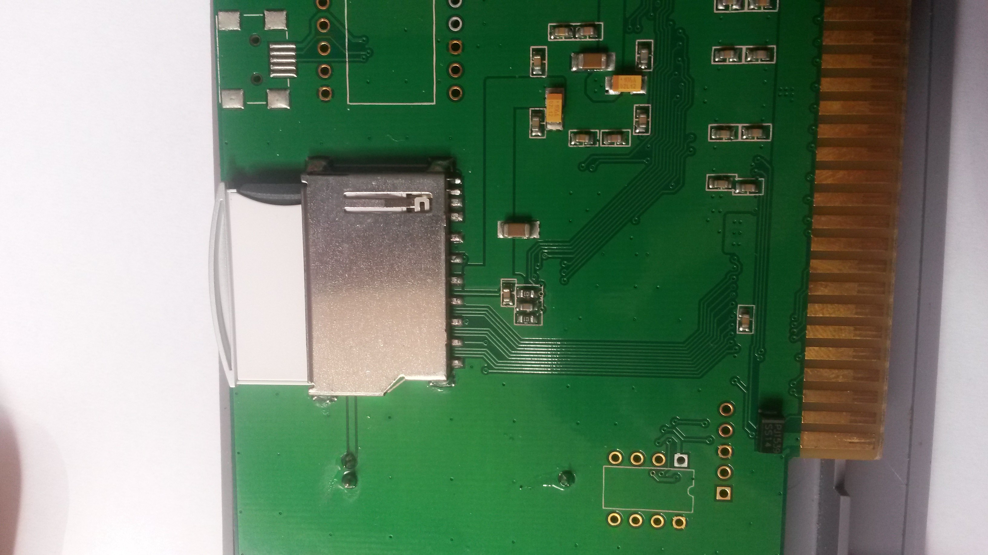

    So here are the pics. You can see that the white sd is alot shorter than the black standard micro sd adapter.
  9. djimport909
    djimport909 Rising Member
    Jul 28, 2015
    54
    Dont worry i didnt destroy a perfectly good batman returns, i used nhlpa hockey and changed the front so it looks nicer.
    So that fits perfectly and has no problems reading from the micro sd.
    Much better looking than than normal sd adapter shown below.
    Gutted i cut a perfectly good cart now but at least it was just a sports game!

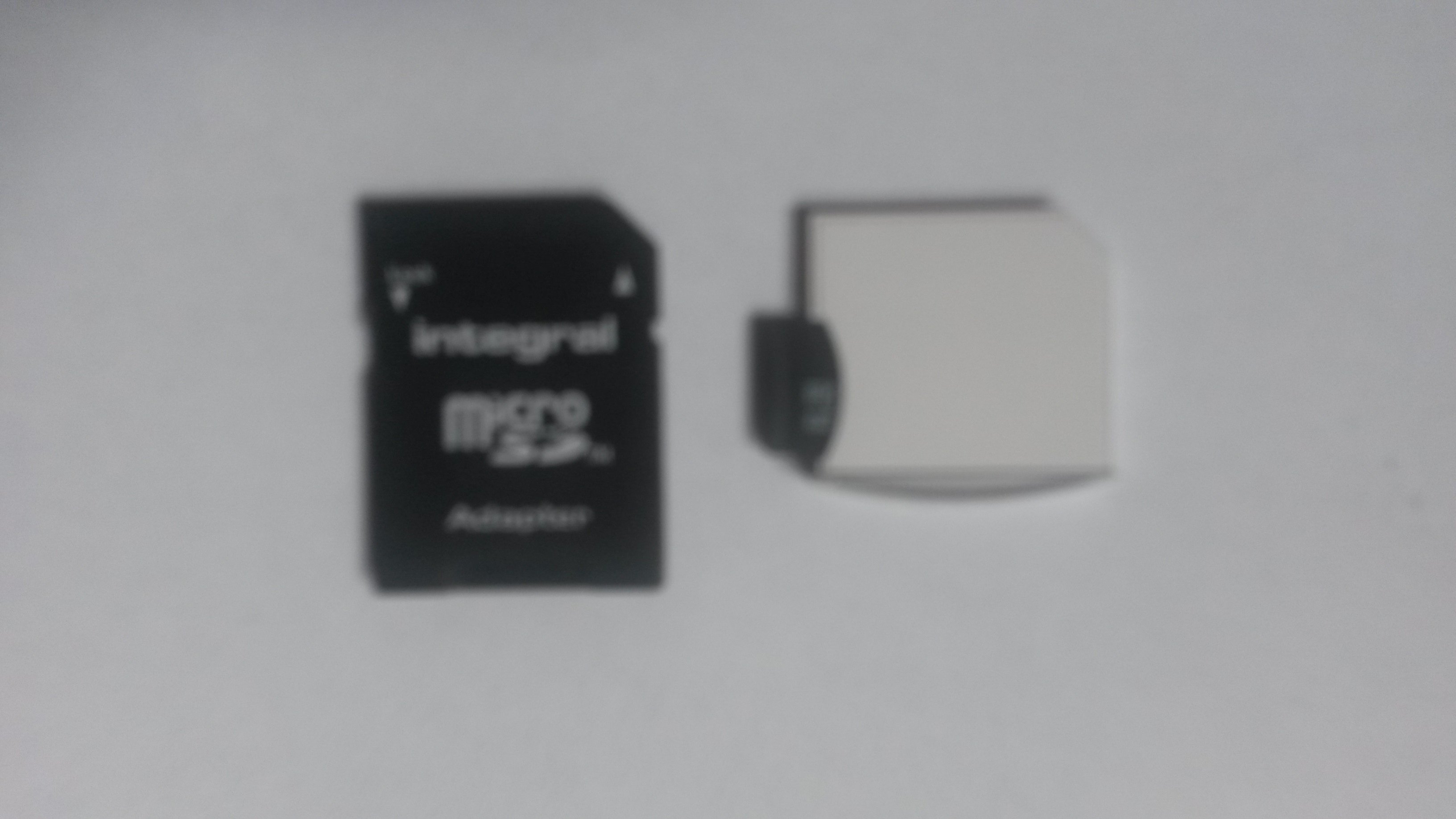

    Darcagn last time i checked on krikzz website he only sold pal and jap cart shells not US ntsc? I could have got one from stoneagegamer but as im in the UK i didnt want to wait for shipping.
    Oh and here is a shot of the 2 adapters to show the size differences.
    So as you can see the stubby sd adapter is about 2 thirds the size of the normal one so now there is an option to use a normal cart for your everdrive, no more hacking apart a working game case or having to pay approx $10 for a replica.
    What do you all think? Hope you all approve!
