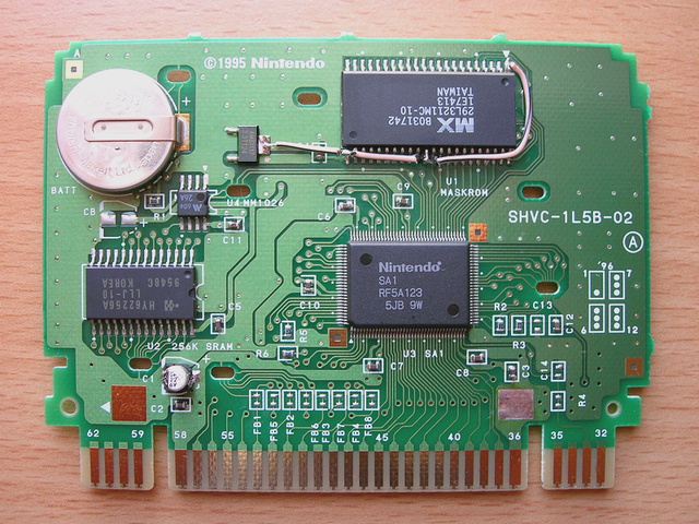

    I succesfull modded a SuperFamicom cart of SMRPG with a 27c322 eprom. I added a ZIF socket so I can swap other SA1 games.
    My question is: in table that shows mask rom -> 27c322 pin equivalence there are, in mask rom part, data address greater than D7. How it is possible? (I'm interested in this because I'm going to do a Starfox cartmod and I like to use a 27c322 bankswitched in four parts, if this tecnique is possible)
  11. Enzo1960
    Enzo1960 Newly Registered
    Jul 2, 2015
    I aswer myself.
    Altought Super Famicom data bus is 8bit wide, SA1 chip can address in 16bit wide, so we can use a 27c322 eprom, that is 16 bit wide. Right?

    I have a few SA-1 and SuperFX SFC carts that I like to replace their eeproms with MX29L3211 with the US versions.
    What would be the right programmer and adapter to flash the 29l3211?
    I am tech savy and would like to do it with minimal expense.
    Thanks!
  13. Pikmin
    Pikmin Resolute Member
    Dec 23, 2009
    935
    95
    I use a GQ4X with an adapter but I'm sure you can get an equivalent for a cheaper price.
    If you are only going to be converting a few of them it might be more economical to buy them pre-programmed from someone near you.
    You might also get people telling you not to go with the 29L3211 because of it's 3.3V maximum rating, Snes runs on 5V.

  15. Bad_Ad84
    1,308
    The issue is, there aren't many cheap programmers that support the chip.
    The gq-4x does, but that programmer has a lot of weird and unresolved issues. I had one years ago and judging by their forum, it's not really improved.
    The tl866 is a great programmer for the money, but no support for this chip.
    You could get a homebrew/DIY solution. Sanni's cart reader/writer also supports these chips. But might be more than you want to spend in small quantities.
    This is why I have continued to offer programmes chips for so many years. Despite it not earning all that much money and taking a fair amount of my time (pms, packing, shipping) and then dealing with orders that go missing (I don't see anyone lose money buying from me!).
    It's more of a public service than for profit.

    Since the SD2SNES does not suppoer SA-1 and SuperFX just yet (if ever), and eBay sells these games for 50$ or more a pop, this is the only "sane" option for people who can solder.
