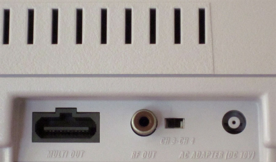

    Okay i will explain a bit here as why im confused.
    For the SNES, how many cables do i have on the back of it to connect to something else? Is it 2 or 3?
    I have the power adapter that is connected to the snes to an electric outlet
    I also have this small rectangle gray thing that i can connect to the back of my snes and it would go to the spot where i already have the antenna plug into it. I'm suppose to remove my antenna for the tv right and replace it with this one?
    Some of you mention about the red, yellow and white cable thats connected to the side of the hdtv. I do have this but the thing is when i look at the other end of it, it has PLAYSTATION ON IT. However, it fits. Is that the cable or it isn't?
    The thing that im really confused now is i had plugged the snes into the hdtv before and it worked. The only thing 100 percent sure is well first off, i used the adapter wire connecting snes to the outlet. But i was pretty close to 100 percent sure that small grey rectange thing connected to the snes... i did connect it to my hdtv. Can someone tell me if i have to do this or not?
    The thing is... i really dont recall connecting the red, yellow, white wires into the tv with the SNES.
    Also for my playstation 1. I know im putting the right wires in it because it works. You see the sony entertainment. Howver, i go to this screen where it say main menu and memory card cd player. I basically can't do anything much in that screen. I took a look at the playstation cd doesn't even spin. None of the playstation cds spin but i did test it out on emulator on my computer and THAT WORKS.
    For the playstation, i connect adapter to the outlet. My tv antenna is connected to hdtv like previously. I also connected the red, yellow, white wire to side of tv to the back of my playstation. I also had to make the tv go from TV MODE TO AV2 mode. Can someone confirm i have to go to AV2 mode to make this work? Only other option is tv and pc and obviously that doesn't work when i click power.
    Also i dont have channel 3. We have free tv using an antenna.
    So can someone explain me the snes setup and if im doing it correct? I was close to sure i didnt connect red, yellow and white wires to it a while back and got it to work. The reason is b/c if i did, i would have used the playstation one. That wouldnt even work though right? IM really confused b/c if it does require a red, white and yellow wire, i only have the playstation one.
    Also for the playstation if it doesnt spin and has that message, that means its going to take a lot of time to fix it or i have to buy something to fix it right? Obviously i wont do it as the playstation isn't even worth much anymore but i just wanted to test it to see if it would work.

    Do not use the Playstation AV cable (R,W, Y connectors) to connect your SNES to your TV, they are not compatible.
    SNES - how to connect to HDTV with RF switch.
    Disconnect antennae cable and connect the cable from the RF switch (your grey box) to the TV/Antennae input.
    On the back side of your SNES console, make sure the channel is switched to channel 3.
    Power on your TV, with your remote bring up the menu screen that has the options to select the input list. There should be an option for TV, select TV. Now use the channel buttons on the remote to either move up or down until you reach channel 3... or select 3 from the numbered keypad on the remote.
    Insert game and power on the SNES.
