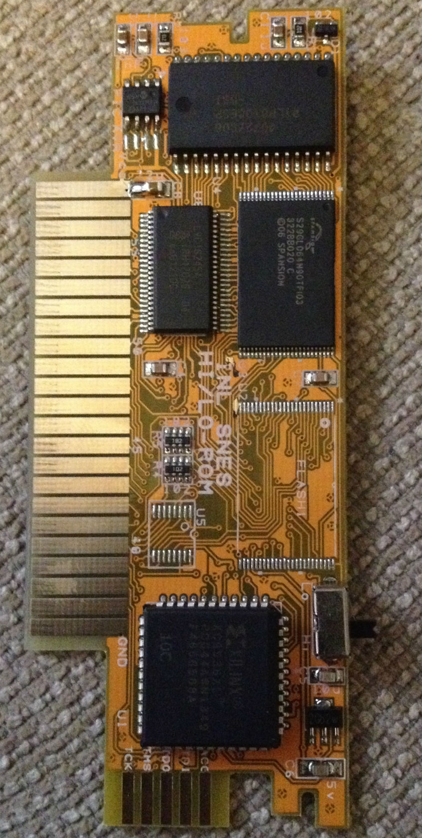

    Maybe someone has installed the SuperCIC-key within the cart and set the pairmode on (for what ever reason). This would explain, why the SuperCIC-lock does not change the mode on reset button pressed.
    Some pics of cart and installation within cart and console might be helpful.

    Open it up and post pics.

  6. Bad_Ad84
    1,309
    You want to check pin 4 of the small chip in the bottom left of the PCB (edge connector facing you).
    Sounds like its connected to ground, which enables pair mode.
  7. AiGHTBiT
    AiGHTBiT Member
    Mar 20, 2014
    Thanks! Do I just disconnect it, or connect it to something else?
  8. Bad_Ad84
    1,309
    Lift the pin, connect the leg via a 10k resistor to pin 1.
    Should sort things out
  9. AiGHTBiT
    AiGHTBiT Member
    Mar 20, 2014
    I now have the PCB, and just checked.. pin 4 on the small chip (CIC?) is not connected to gnd, but pin 8 is :/
    I think this is the board: http://www.infiniteneslives.com/aux5.php and the site says it has "Multi-region CIC (press console reset to lock onto alternate region)" .. doesn't seem to play very nice with the SuperCIC in the SNES..
    Edit: tried your suggestion anyway, and it works! I can now change region as usual with the supercic :)
