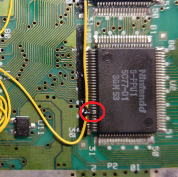

    You should make detailed pictures of your soldering work. Especially from the two PPU's.
    Could it be that you lifted the wrong legs? Or did you maybe bridge something?

  4. borti4938
    borti4938 Robust Member
    May 8, 2014
    205
    64
    Is there a short soldered between leg 23 and 24 of S-PPU1?

  6. Pikkon
    Pikkon "Moving in Stereo"
    Mar 4, 2005
    2,695
    80
    Your wiring looks different from mine when I modded a pal snes.
    What guide did you follow.

  8. borti4938
    May 8, 2014
    205
    64
    The wiring looks good to me. Are you sure that there is no short?
    Otherwise the problem might be something different and has nothing to do with the SuperCIC.
