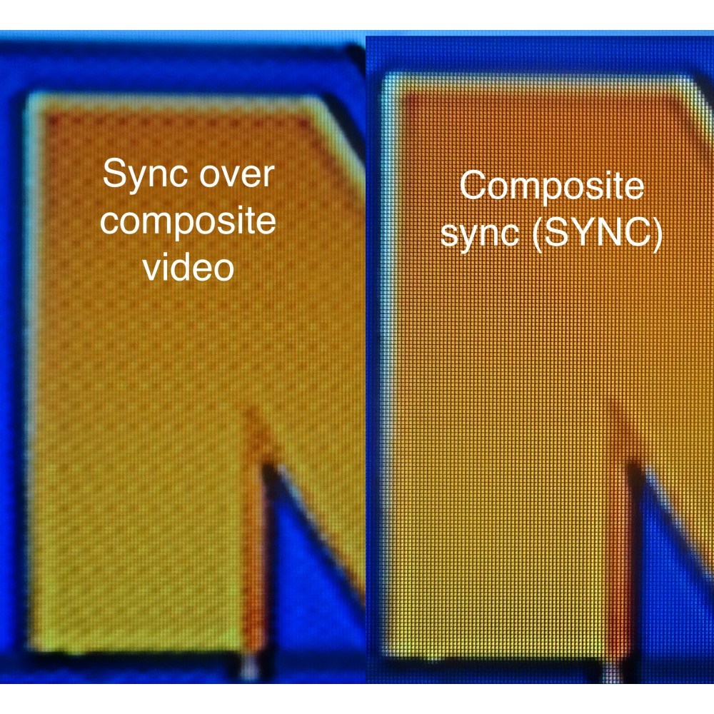

    Here are some info about those: https://www.retrogamingcables.co.uk/composite-video-vs-composite-sync
    Thanks!

    RGC are generalizing the issue and make it seem that CSYNC from the console is the fix to all possible problems.
    That isn't entirely true though: CSYNC cables *can* help with *some* issues, mainly high frequency interference.
    The thing is, on a good cable, there should be minimal interference and it should not affect the image quality.
    What's worse is that CSYNC out of consoles is always non-standard. The signal levels can be anywhere from 2V to 5V and may or may not be able to source enough current for the usual 75Ohm termination in the receiver.
    It's much simpler to just use Composite or Luma for sync, which is always standard in all consoles that support it.
    To make it simple for your case, @helakustorm, your Trinitron will produce the same image quality with all possible cable types.
    (Those TV have nice sync strippers and accept a wide range of signals flawlessly.)
    Just make sure you don't buy the cheapest RGB cable on Ebay. You can't fix a cable with bad shielding.
