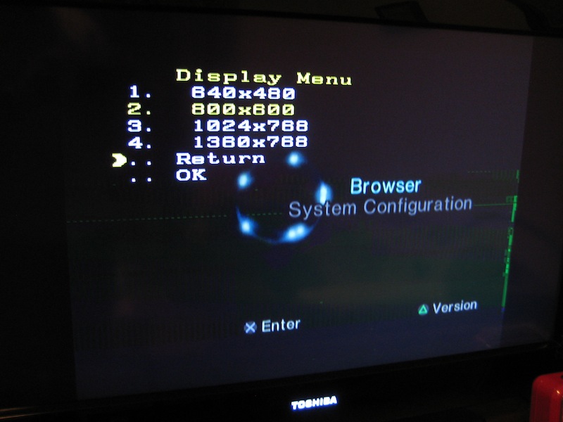

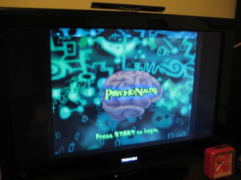

    Yesterday I got home a PAL PS2 and I got the exact same symptoms as with my PAL MD1. My PAL-50Hz consoles don't seem to work properly with the setup:
    1- Audio is fine, you can hear perfectly the game.

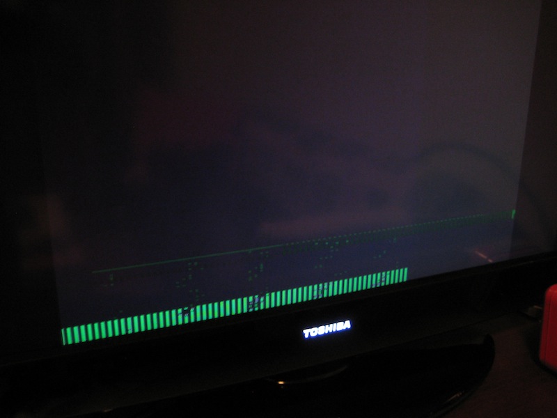

    2- Screen is mostly black, with some artifacts.

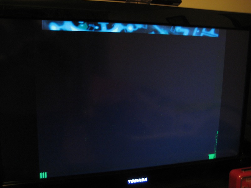

    3- Top 5% of screen shows the game in motion as it should (at least with PS2):
    4- When I try to change the scaler mode (RGBH, YCBCR...) or its resolution, the screen refreshes for a second and leaves a ghost of what the console was outputting when I made the change:
    (you can actually see the top 5% still moving, but the rest of the screen is still)
