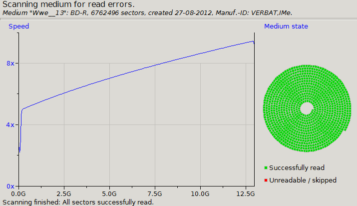

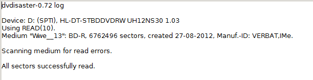

    Here's a test I did with my WWE13 build. It's on a bluray (single layer) and took just about 2-4 minutes to check every sector for readability.

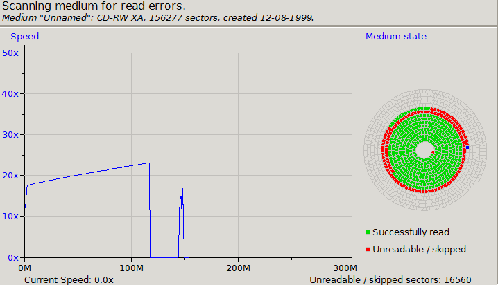

    And this is a CD-RW I have that's been thoroughly scuffed by my xbox. I burned a build that has issues to show what unreadable sectors would be like. As you can see in this it's currently reading and cannot read certain sectors - thus making this disc worthless since it would have read issues.
