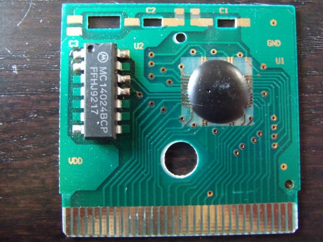

    I recently obtained a batch of retro games and've been testing everything prior to putting them up for sale.

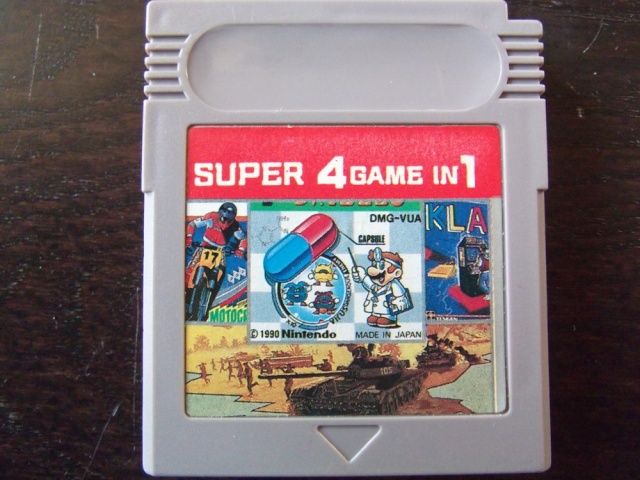

    Among these were two bootleg GB cartridges, one of them being a multi-game card.
    On the cover there are 4 games mentioned:
    - Motocross Maniacs
    - Dr Mario
    - Klax
    - some tank game, anybody know which one?
    As you can see, it looks clean. It works perfectly, bar the fact that I DO NOT know how to select the other games.
    By default, Dr Mario starts up.
    I had Klax boot for a couple of times, but I can't seem to work out what button combination or whatever it was...
    If anybody knows if these types of games have a standard button press/hold/combination at boot or whatever, I can figure out how to select the other games to test.
    Thanks.

    I'll bet the tank game is Battle City, maybe under a different name, since that seems to be on every GB (and NES) multicart.

  5. Shinebi
    Shinebi Dauntless Member
    Jul 6, 2011
    744
    ...as I already tested different button holds on power up/Nintendo chime, I doubted it was one of these.
    The 4th game is indeed Battle City, as 7Force suggested.
    The game selection mode is again, indeed by powering off/on really fast as 7Force suggested in the chat.
    Thanks for that :)
    Game boot order is this as follows: Dr Mario/KLAX/Battle City/Motocross Mayhem
    Any idea what these bootlegs go for? As I'll be putting this one and Turtles (HK bootleg/Japanese version) up for sale soonish.

    Sounds like they copied the design Atari used in their official 32-in-1 for the 2600 system. No way to change game other than powering off/on and almost always get the one same game every time. Awful design.
    That chip is a 7 bit binary counter being used as bank selector, you could try ripping the chip out, install a 2 position DIP switch, one end to pin 11 and 12 and dd a 10k pull up resistor from that 2 to VCC source, other end of the DIP switch to ground source. You will always get the game you want by setting the switch. It's what I did to my 32-in-1 long ago. Easy hack once you figure it out.

    Well, it works as it should: no problems switching games, so I'm going to leave it alone.
