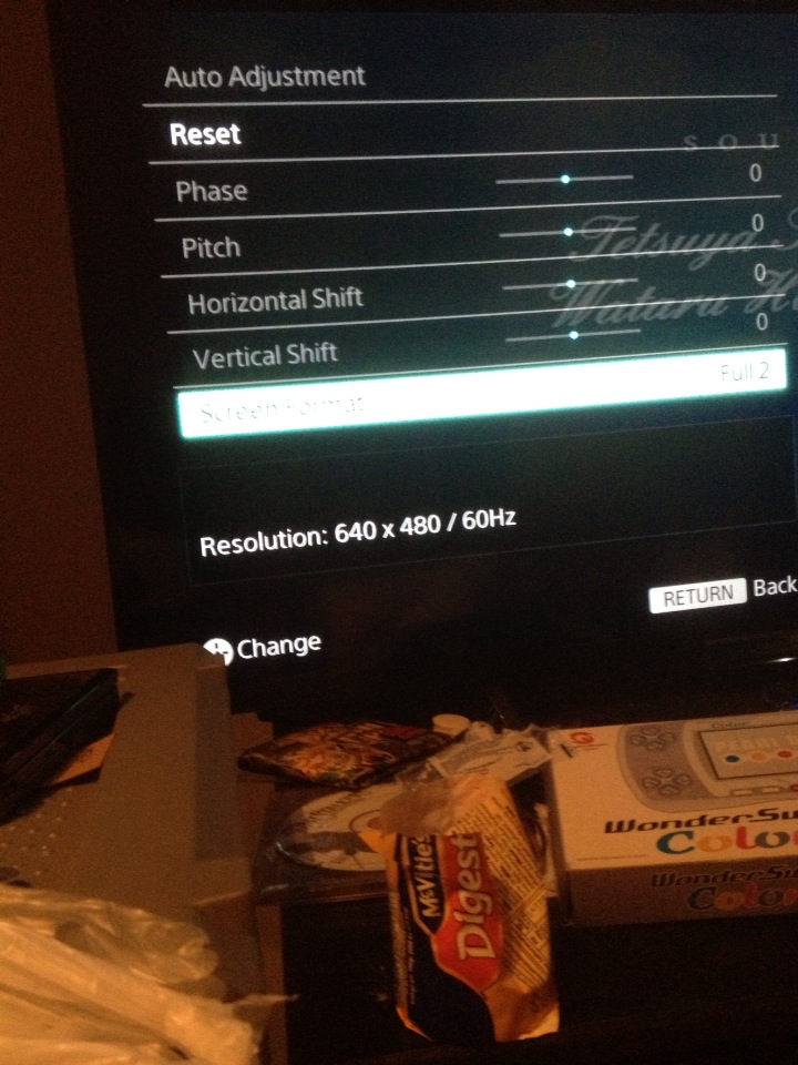

    Quick question , i just got a hdmi upscaler and as you can see in the picture it says 640 x 480 does this mean its not being upscaled?
    I am a bit of a n00b at this so just concerned!

    Any modern TV will always show it's original resolution. So if it's a full hd tv, 1920×1080. It doesn't matter if you are feeding it with a blu-ray or an Atari2600. Whatever shows up on the onscreen display as a resolution is simply to inform the input resolution of that particular source. The TV will always "upscale" to it's original resolution, but since it doesn't have a good upscaler to begin with, the image result of anything lower than 480p is very bad.
    Finally, to answer your question, no, the HDMI upscaler you got is just converting the analog source to digital, not doing any sort of upscaling.
