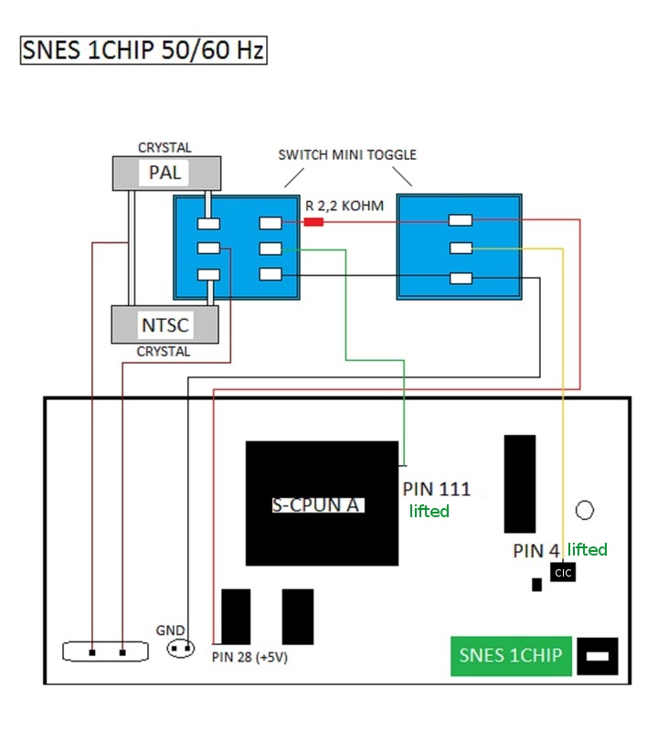

    Hi I'm doing a mod. 50/60 release to a snes and the region, but a wrong cable assembly, gave me melted broken and would not light up, the fuse I replaced it, but I find all the ground and positive points in short, I do not know that component ruined can give this effect. I replaced the fuse, unsoldered the 7805, but I always positive and negative shorted even from the holes of 7805.
    What should I test?
    Thank you

    Can you make a high resolution picture of your SNES and point out where on the board you did modifications?

    The mobo is a chip01, in short are not unsoldered pins, those I tested them with tester, only the merged went. I do not see any drops of tin on integrated, it altro..tutto was turn on the console and the 7805 controller has warmed up a lot; Then at the second firing it is not turned back on.
    The installation and the one on the attached link, only that I had connected the 5V with the second switch. I can not post pictures as I have no means to do so.
    https://playoffline.wordpress.com/mod/1chip60hz/
    2nd photo is the real pattern that I used.

    It's impossible to help without a photo.
    You've shorted something so check over your modifications under a microscope (or reverse them).
