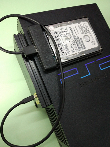

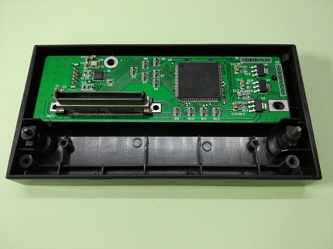

    ppl still make DEV9 stuff
    this is new one USB on EXP Bay....

    PS2 Fat can boot from PS2USB, becase a hdd (with mbr.kelf from FHCB ,osdmain.elf (really my custom OPL) on it) is emulated. After my OPL get to run ,it switch the adapter to USB mode.
    The main design goal is user friendly ,so I chose exfat hdd format instead of (but compatible with) PS2 format.

    The emulated hdd is just for BOOT. Hdd requests are translated to internal flash to access MBR.KELF and a simple PS2 Filesystem ( osdmain.elf). USB must be accessed through custom irx .
    One can add ps2netbox/ps2usb support to some software in two method .
    If source code is public, just recompile to include custom irx.
    If no source code ,need crack/patch to include the irx .
    For popstater/pops , since it load usbxx.irx, I write one . But this seems very odd :
    Code:
    POPS -> pfs0,pfs1 -> redirect to mass0 -> redirect to ps2netbox/ps2usb.
    Hardware emulation is possible ,but is very complex . So I use software method .
