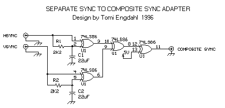

    3- Here's a quick schematic I did using icons from this forum (colors and models can vary from picture), can anyone find anything that could go wrong with this setup?

    Do you have consoles that have both euro and Japan SCART cables? If not, then it's a simple case of either using the cable it comes with (if using Japanese SCART) or buying a replacement one suited to euro scart. Should work fine with a switcher, in fact, using a switcher might solve the signal acquisition delay that the xrgb mini has when directly connected.

    If I may make a suggestion, I would recommend you get a sync combiner, like the Kenzei or Toro from beharbros, to use with the Dreamcast instead of VGA to Component. It creates an unusual 480p 31khz RGBS signal but the Framemeister is one of the very few things that can handle this strange signal. The high-pass filter on the RGB in is much better than the D-terminal (component) input.
    EDIT: Also forgot to mention, that you can run your PS3's HDMI signal into the Framemeister as well if you wanna save a HDMI port on your TV. You can also run the media PC into the Framemeister too, since it has 2 HDMI inputs.

    Also, if you want to use Dreamcast 480p (VGA) to Framemeister, you can also just build a sync combiner circuit.
