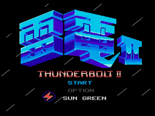

    During a search for undumped/unemulated MD games, I stumbled about this unlicensed shooter which was apparently part of Gamtec series and is considered to be
    quite "rare" by the people who own a copy.
    From the link below, it seems the game was dumped but the dump never released publicly because it "did not work on emulators or flashcards" (well, like most of those unlicensed original games which have on-board copy protection... until someone cracks them)
    http://www.sega-16.com/forum/showthread.php?21924-Thunderbolt-II
    http://s4.zetaboards.com/PGC_Forums/topic/9875962/1/

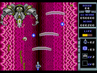

    Out of curiosity, I contacted one of these fellows to see if they still had the "non-working" dump so I could had a crack on it.
    Hopefully, it appeared that the dump was complete and that the copy-protection used by the game is identical to the one in many other unlicensed games from this area (16 Tiles Mahjong II, Smart Mouse, etc) so it literally took 10 minutes to crack it.
    Basically, the game expects hard-coded value to be returned when reading address $400000 and $400006, which are normally not mapped on traditional cartridges (or flashcarts) but maps to extra cartridge hardware in these games.
    So much for the talk, here is a link to the patched ROM, which should work on any emulators (tested on Fusion) or flashcarts (tested on Mega Drive Model 2 with Everdrive MD)
    http://filetrip.net/dl?sKzJoiYp7x

    I just had a look and it indeed hangs on Gens. The (technical) reason is that Gens does not properly emulate HV counter address mirroring which this games relies on (although it seems more like a programmer mistake to access those mirrored address). You have to keep in mind that Gens (and all his forks) is still based on the good old core from 2006 and so is quite outdated.
    Saying Fusion (or even Regen on that matter) is outdated just because it hasn't been updated for a while is quite misleading however, it's still more compatible than Retrocopy or Mednafen and accurate enough to run 99% of Mega Drive games just fine, including this one.
    I am not sure what you mean by that but I tested it with Everdrive MD + Mega Drive 2 and it worked fine, I was able to complete the first level without issues. Also, saying it crashes "because of the sprites" does not make much sense (if any). Slowdown is caused by software having too much things to handle, it happens in quite a lot of shooting games and shouldn't have anything to do with crashing
