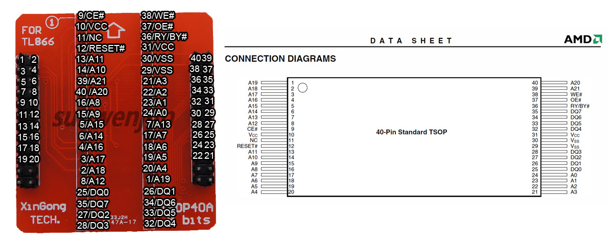

    This should be it, no guarantee though that is 100% correct
    jaskamakkara likes this.

    Thanks for the replies!
    That's very helpful, sanni, I appreciate it - exactly what I was looking for.

    I appreciate that, but actually I managed to build my own adapter using the pinout Sanni supplied, it works great :)
    Thanks for all the help!
