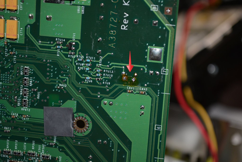

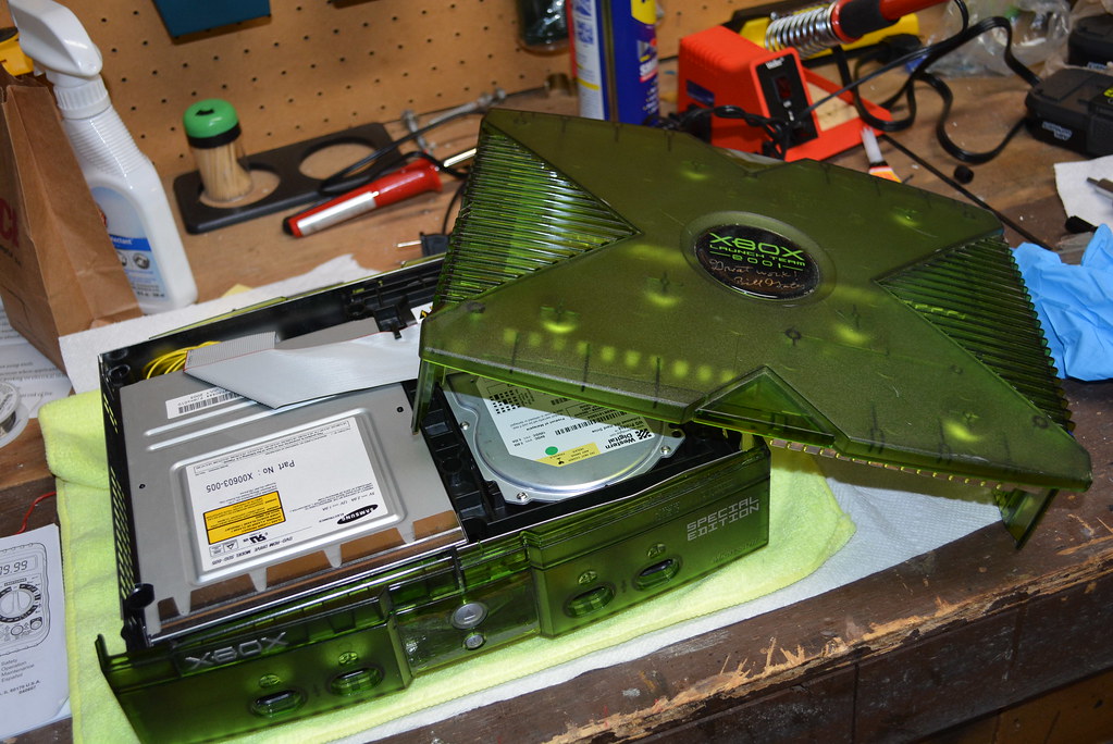

    The cold has kept me indoors for the most part. So I've picked up a lot of side projects. Unfortunately between wrenching cars and fixing up watches, I haven't been able to document the video game hardware I've been modding. However, I did get a new SD card and I wanted to try out the camera, so this weekend I got to removing the old Xbox enemy, the clock capacitor that loves to fail and leak.

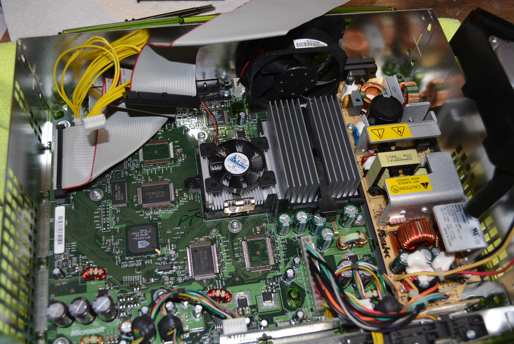

    First up, our old friend, LT 2001 Xbox. I've already opened it up before, so no need to bring out the pitchforks. When I received it the DVD drive was dead so I had to replace it. I thought about doing the clock capacitor then, but from the view I had it looked "OK". Turned out I was wrong.
    Here's a photo for documenting sakes for the LT2001 Xbox, looks like standard v1.0 board as far as I can tell (please note if you see anything different).

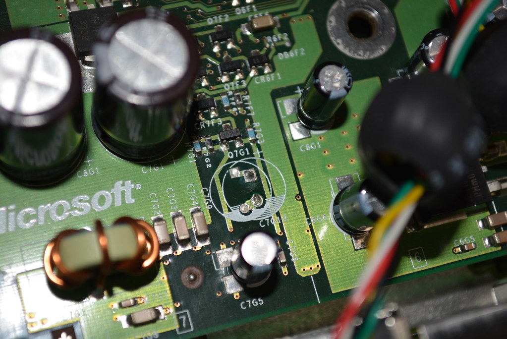

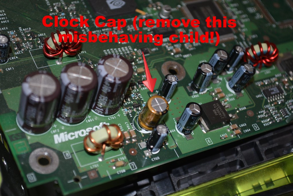

    Here's the little bugger that tricked me! When I looked at it months ago, I was like "meh looks alright", turns out when I removed the motherboard, it was leaky leaky leaky.
    And here's the damage. Not the worst one I've seen. But still. That is acid or alkaline on the PCB, on one of my most used console :(

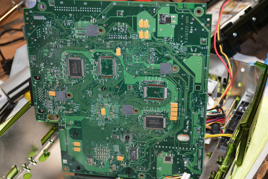

    More LT2001 documentation photos, again, I don't see anything un-natural, looks like the standard v 1.0 board. (Pretty happy about how clean this motherboard is considering its 15 years old now)

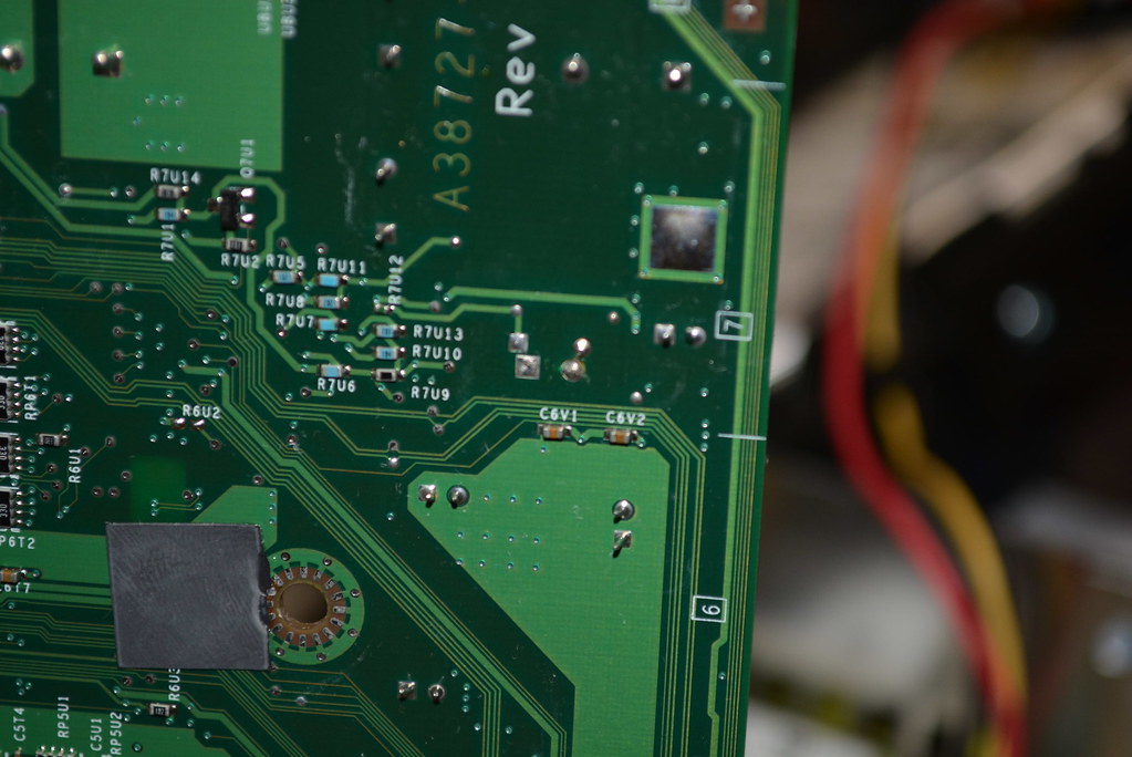

    Bye Bye little bugger. I did the normal method thats been documented all over. I put some solder on the back of the motherboard where the capacitor is. Then heated up the newly soldered in solder to melt the old solder connected to the capacitors pins... and the capacitor comes right off when you do this method.
    Here was the hard part. Removing all the old acid/alkaline. This was a strange leak because, almost none of the acid/alkaline got to the front of the motherboard, it all leaked on the 2 metal wires of the capacitor and went to the back of the board. I used some soft neutralizer and some rubbing alcohol, it came off clean after 20min of softly and carefully cleaning away.
    Moment of truth... looking good.
    Closed and cleaned up. Now this bad boy is ready to run another 15 years!

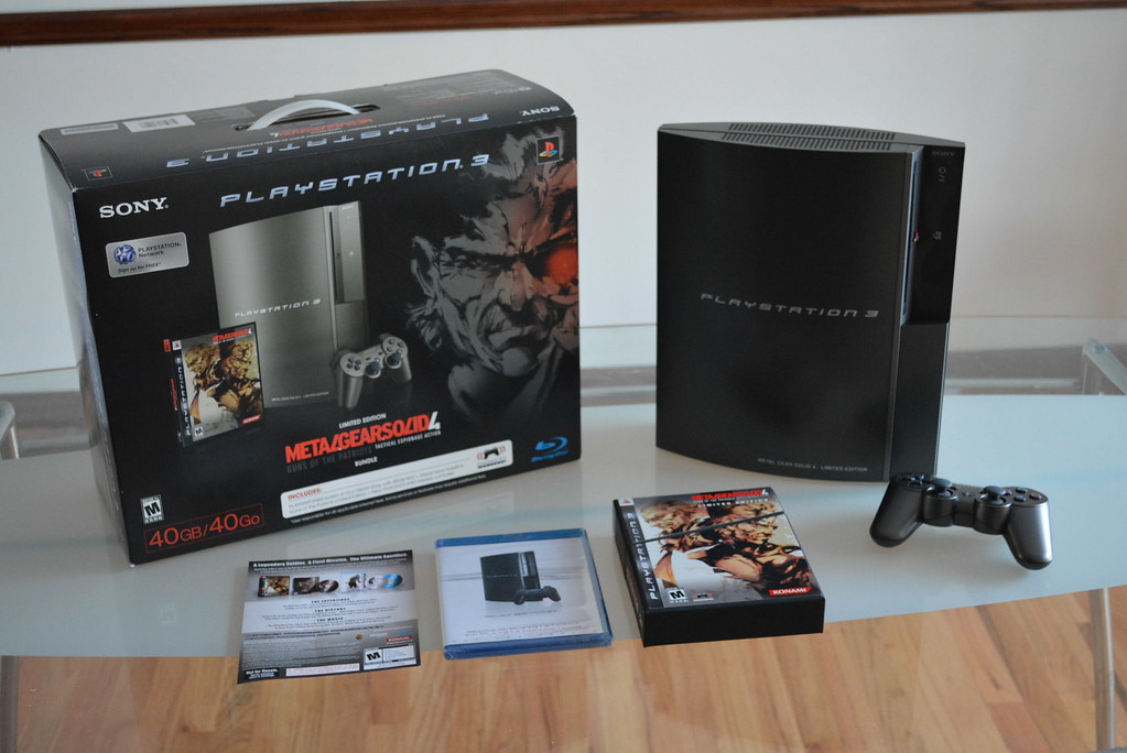

    I finally stumbled on a happy medium the other week by mistake. And I'm glad to finally say I have this console in my collection.

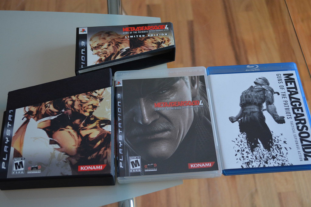

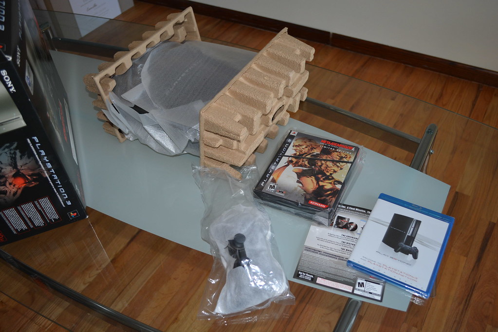

    It's nice to know that someone cared for this console, pretty much everything from new is still there. Wrappers, Papers, Manuals. It's like opening up a time capsule.
    The included Blu-Ray disc was never opened... I can see why. Who wants to watch a Blu-Ray disc of just a bunch of trailers? lol
    I was lucky in the fact the owner didn't sell the original MGS4 Limited Edition game, a lot of the bundles are missing the game. Also lucky the controller is in great shape. Painted PS3 controllers can wear pretty noticeably.
    Good stuff inside:
    The engraving at the bottom of the console, and a good look at the Gun Metal Color.
    The full house:

    Now that you reminded me, I shoulda posted in the photos that the outside art isn't actually a box. Like a lot of LE consoles, it's actually a sleeve. Inside the sleeve is a white box that is the exact same dimensions as any other PS3 box, but without any writing on it.
