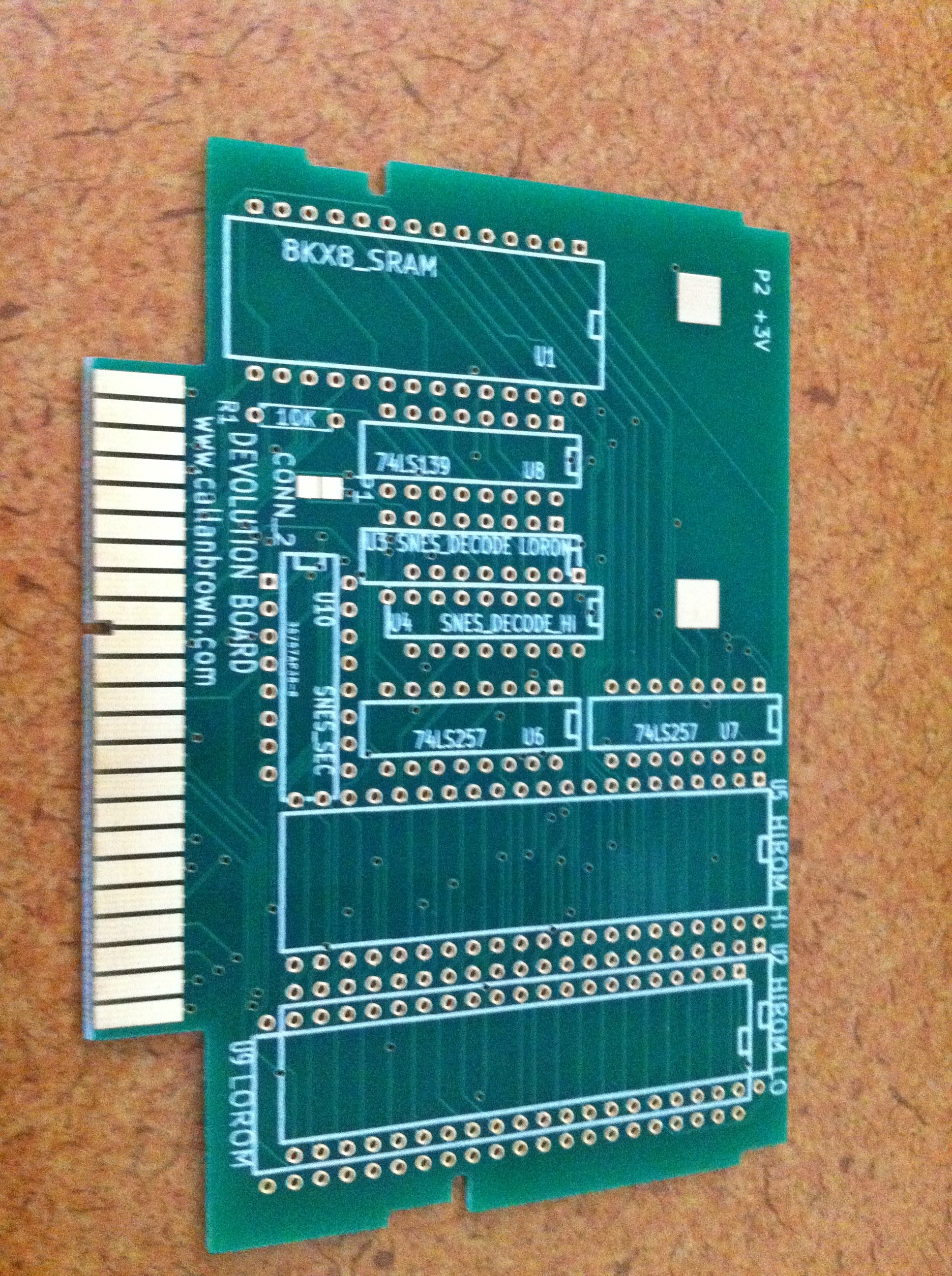

    Hi,
    I recently purchased some new SNES PCBs from www.callanbrown.com (Who by the way is super cool and helpful!)
    Now, he uses the workhorse 27C322s on them. But, I am really looking for a more viable (cheaper) easier option. 27C322s are notably more expensive than most EEPROMs and in the US you have to either order 180+ at a time or order from China and wait a month for delivery. Callan personally doesn't use EEPROMs so was really unable to point me in the right direction.
    Now, I have spent time (a lot) googling and searching. There are even a few posts talking relatively about it here. But, I want a definitive answer.
    Is it FEASIBLE for me to continue this route (cost, easy, availability) with EEPROMS.
    Now, look... I am a novice at best at understand all this. I am really trying to educate myself as best as possible. So, bare (or bear even) with my ignorance.
    But, do they even make EEPROMs with the same/similar spec as the 27C322 in DIP format? If not, I would need to buy TSOP to DIP adapters for everything. Which already cuts in the "cheap" and "easy" factor. TSOP scares the shit out of me, to be frank.
    Here is what the board looks like if it helps.
    Also if it makes it easier. The datasheet for the 27C322s that I would most likely use if I can't get EEPROMs
    http://pdf1.alldatasheet.com/datasheet-pdf/view/22823/STMICROELECTRONICS/M27C322-100F1.html
    Thanks in advance for ANY advice if I am barking up the wrong tree. Or if I am asking retarded questions.

    Yeah, I was just trying to mitigate the delay in shipping time from China since the US doesn't carry them except in 180+ quantities. Also, since I do not own a decent UV light... was trying to save from setup costs as well.
    Thanks, bad. This is enough reason for me to realize I should just stick with the 27C322.
    Appreciate it.
