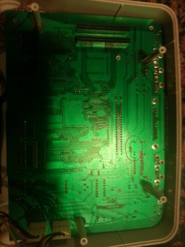

    There is a resister soldered on to the back of the board:
    I'm not sure why they put that here, or what it would do to fix it.

  2. retro
    Wow, that's a lot - especially for an untested one!
    The resistor is probably meant to be there - either because it wouldn't fit on the board, or to correct a design error. It's common.

  4. retro
    Leave the resistor alone! It could well be a different version with that issue corrected.

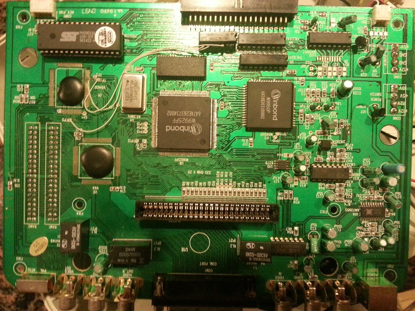

  6. HEX1GON
    The wires are normal too, it's dead somewhere, but not worth the trouble.

    As I keep saying, wires, resistors etc. are often found on a retail, sealed product due to either an error in the layout or simply not being able to run a trace between two points. It was done by Bung - stop worrying about it!
