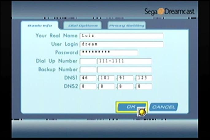

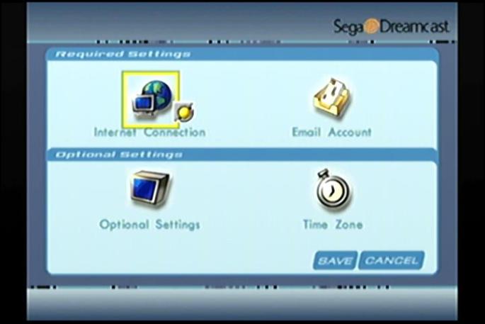

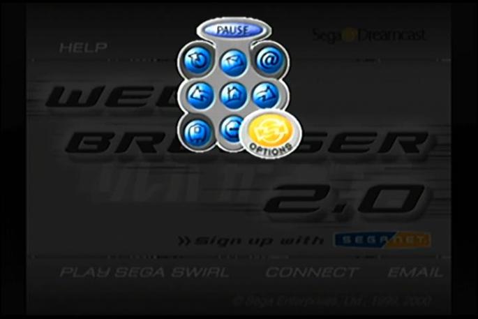

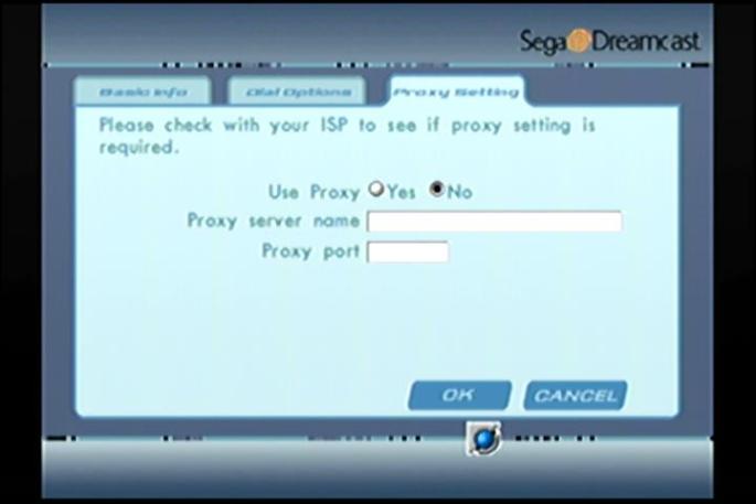

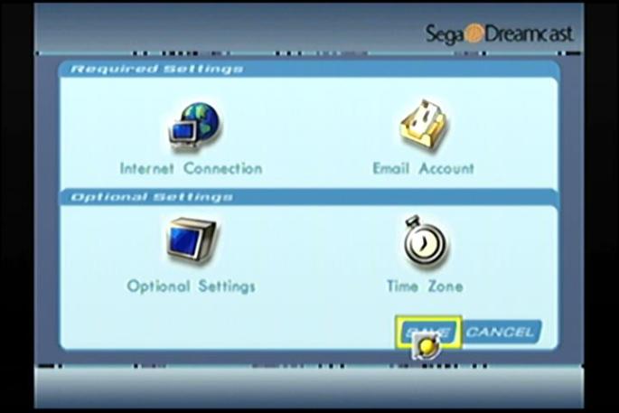

    To configure Dreamcast you will need to have a Dreamcast browser such as Planet Web (Any version), XDP or another and make the following settings:
    Go to Options and then Internet Connection:
    Your Real Name: Enter your name.
    User Login: dream
    Password: dreamcast
    Dial Up Number: 111-1111
    DNS1: 46 101 91 123
    DNS2: 8 8 8 8

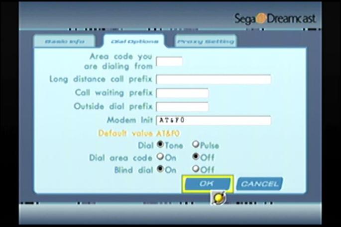

    Area code you are dialing from: [Leave it blank]
    Long distance call prefix: [Leave it blank]
    Call waiting prefix: [Leave it blank]
    Outside dial prefix: [Leave it blank]
    Modem Init: AT&F0
    Dial: Tone
    Dial area code: Off
    Blind dial: On
    Use Proxy: No
    Proxy server name: [Leave it blank]
    Proxy port: [Leave it blank]
    Your Dreamcast is ready!!! Now just save these settings.

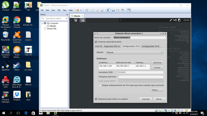

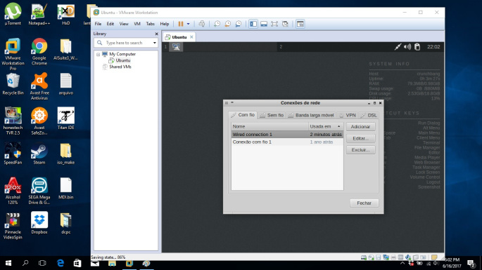

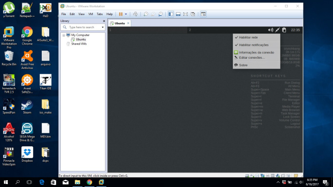

    In the upper right corner, right-click on the connection icon, and then click Edit Connections.
    Then select your first connection and click on Edit.
    Click IPV4 Settings and leave it like this:
    Address: 192.168.1.150
    Netmask: 255.255.255.0
    Gateway: 192.168.1.1
    DNS Servers: 8.8.8.8
    Save these settings.

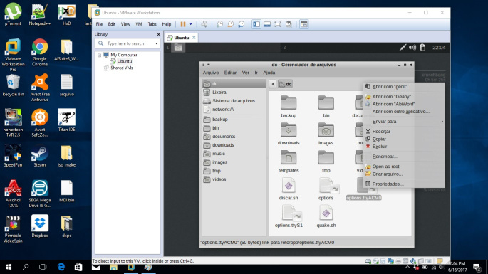

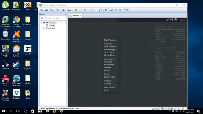

    Right click on the desktop and then click on File manager

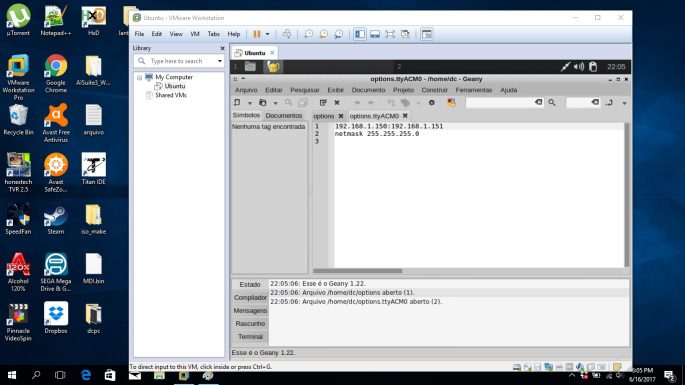

    Right-click on the options.ttyACM0 document, and then open it as root[​IMG]
    Change the first line of the file like this: 192.168.1.150:192.168.1.151 And then save the file.

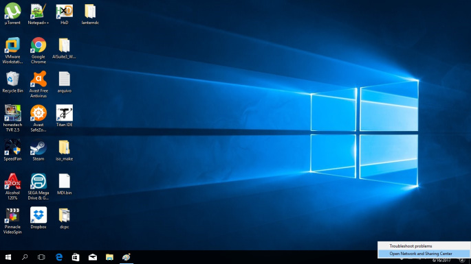

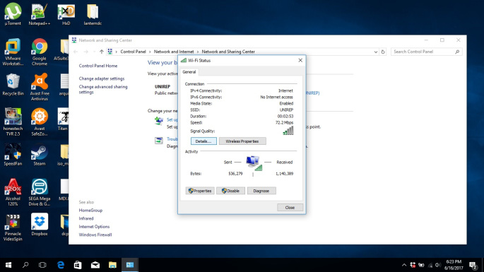

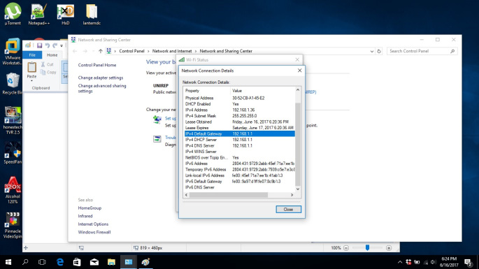

    Now on Windows in the lower right corner, right click on the wifi or internet icon [​IMG]

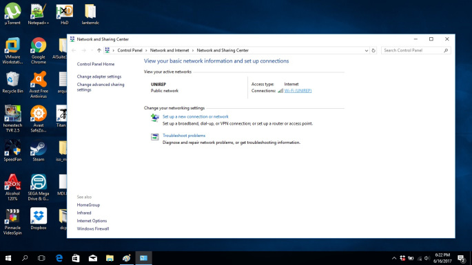

    And then open the Network and Sharing Center
    Now click on the connection you are using, and then click on Details[​IMG]
    In the next window look for IPv4 Default Gateway and note this number

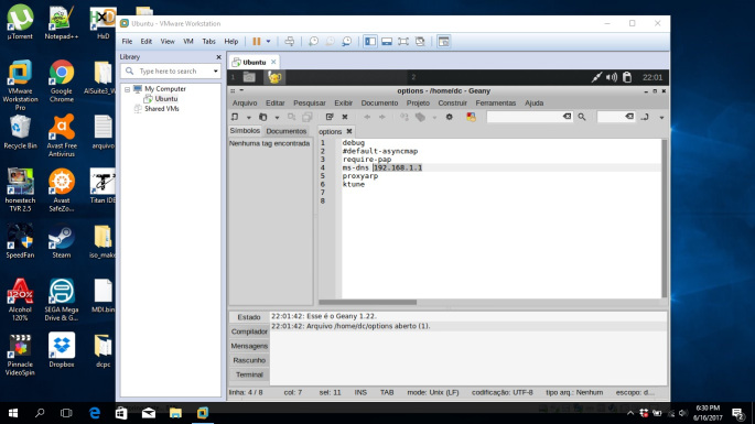

    Back to the Linux now open the option file as root and paste the ip number in the fourth line as shown in the image below
    Save the file and close the windows. All set on your PC.

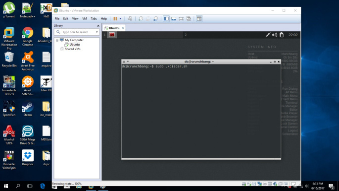

    When you are using the Fax Modem, make a test to see if it is working. With the virtual machine open connect the modem to the USB and in the upper left corner of the virtual machine, click on player, removable devices, USB Modem and then check the disconnect from host option.
    Now right click on the Linux desktop and then click on terminal. Press up arrow until the sudo ./discar.sh command appears. Press enter and then enter the password dc. Your fax modem should have both lights on.

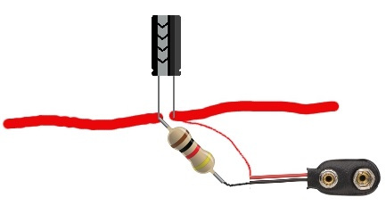

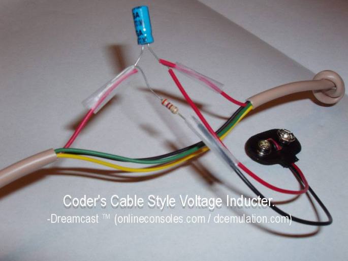

    Building a Line Voltage Inducer
    To build a line voltage inducer you will need the following components:
    1. A capacitor 0.47uf
    2. A resistor 380 Ohm
    3. A battery connector 9v
    4. A battery 9v
    5. A soldering iron, tin (welding wire) OR insulation tape.
    (This procedure is necessary to simulate the electricity that exists in a telephone socket).
    First you will pick up the phone cable and you will open it (Be careful, dont break the wires). Inside it you will find two wires one white and one red. You will cut the red in the middle and will bind the components as follows:
    If your phone cable has both wires of the same color, cut the right one with the connectors facing up and the pin facing down.

    When the virtual machine loads the operating system, right click on the desktop and click on terminal. Put the browser on the Dreamcast and then click connect. While Dreamcast is dialing inside the terminal that is open in the virtual machine press up arrow until the sudo ./discar.sh command appears. Press enter and then enter the password dc. Your fax modem will have both lights on while the Dreamcast is dialing. Now just wait.
