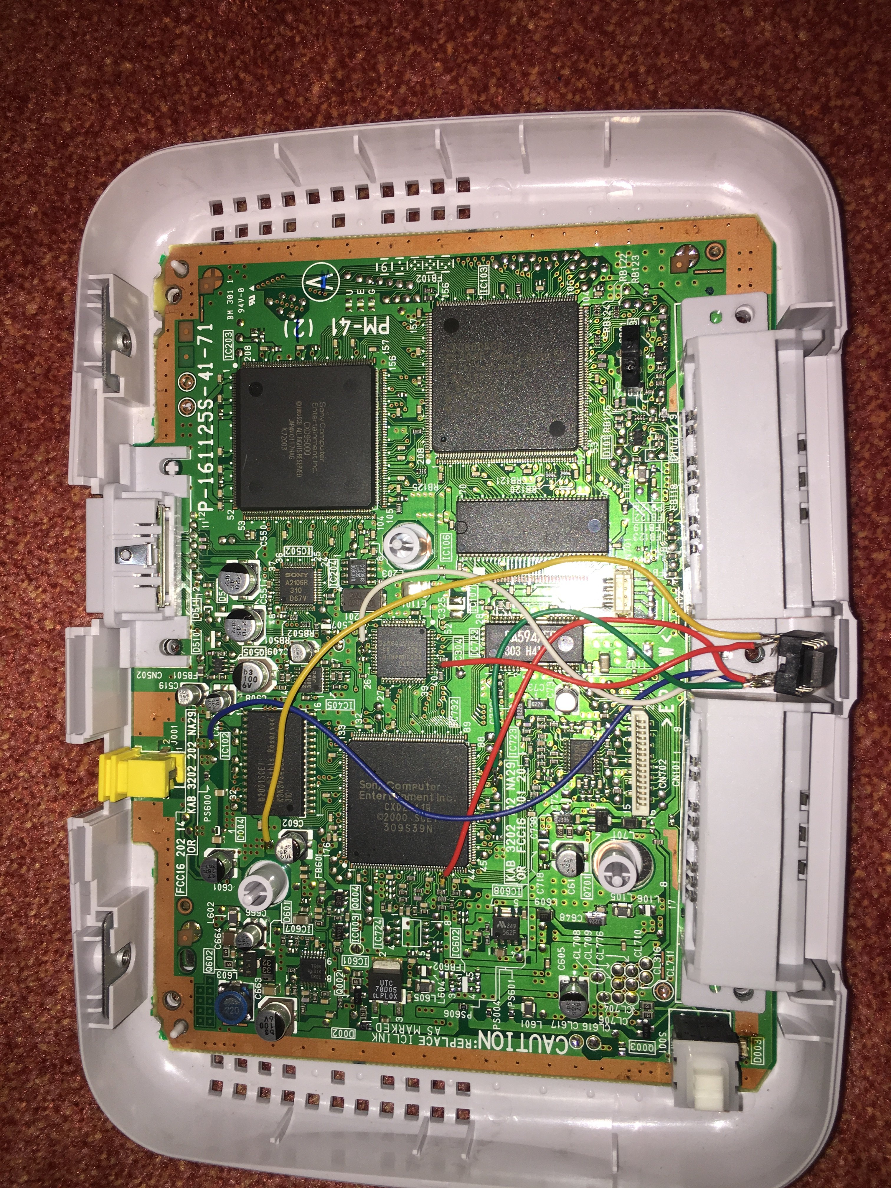

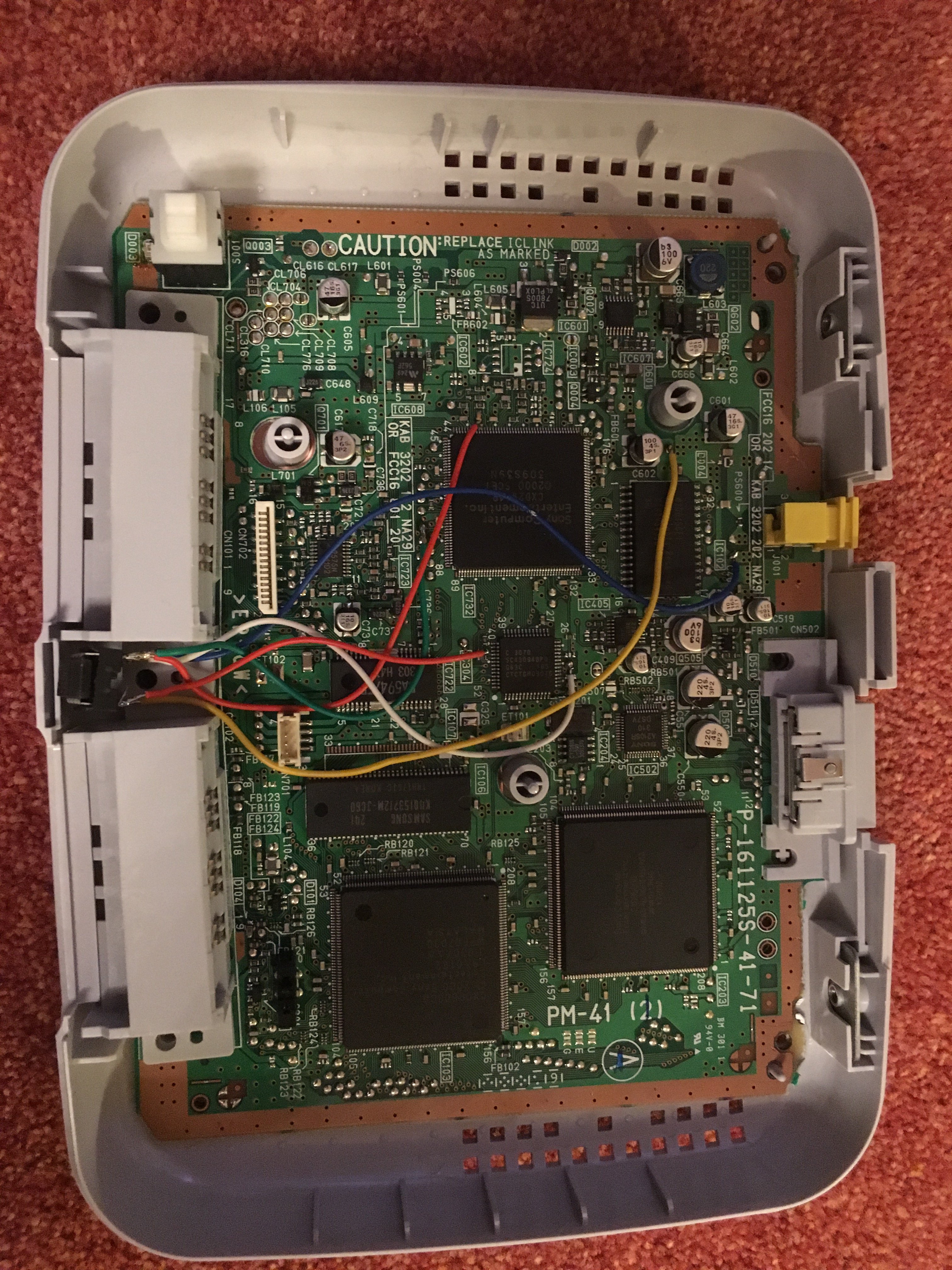

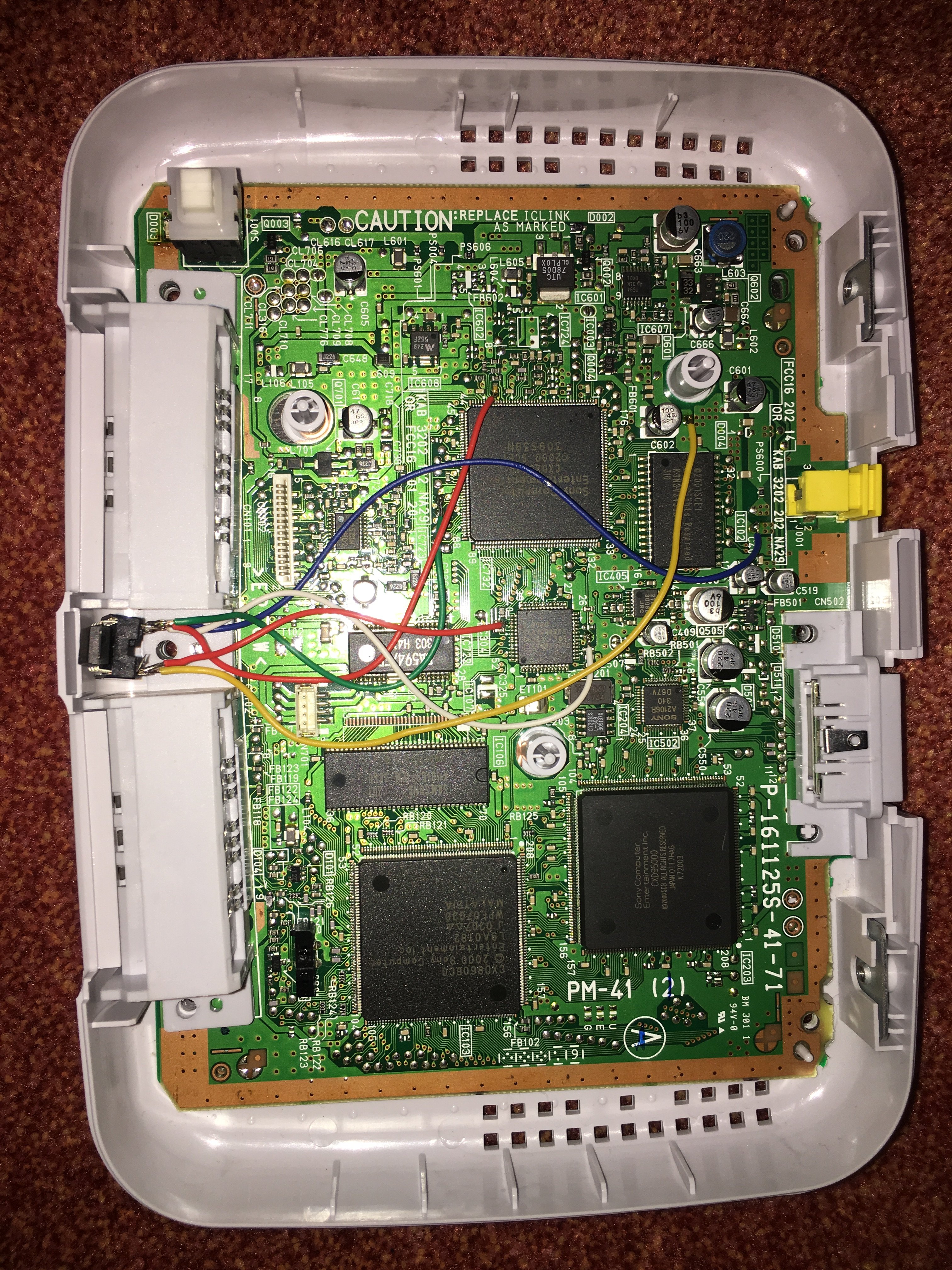

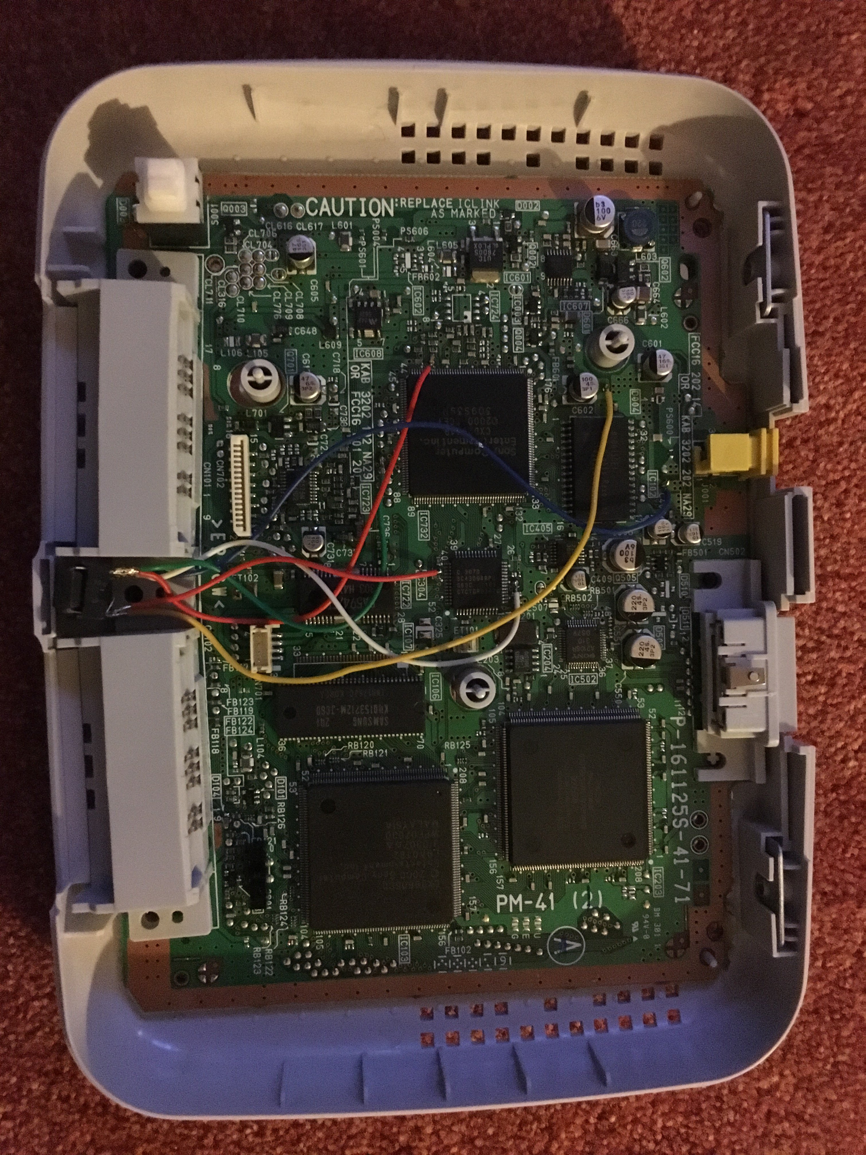

    Hello guys,
    I've programmed a Mayumi 4.0 for my PSOne. I soldered it in combination of some solder points.
    The chip actually works, but not always. Mostly after switching it on. The thing with the open lid does not change any behavior.
    Anyone got some tips for me how to fix this?
  6. LeHaM
    LeHaM Site Soldier
    May 5, 2013
    2,634
    292
    Pal or ntsc
    What version motherboard
    Where did you buy the pic
    How did you program it
    Photo of install please
    XeroX likes this.
  7. XeroX
    XeroX Newly Registered
    Jun 23, 2017
    Hello LeHaM,
    PAL
    PM41-2
    Mayumi 4.0 programmed with PicKit2 via MPLAB X
    12F508
    I have to admit I did this 2-3 month ago. I combined some install diagramms as there haven't been any for PM41-2
    Thanks for any help

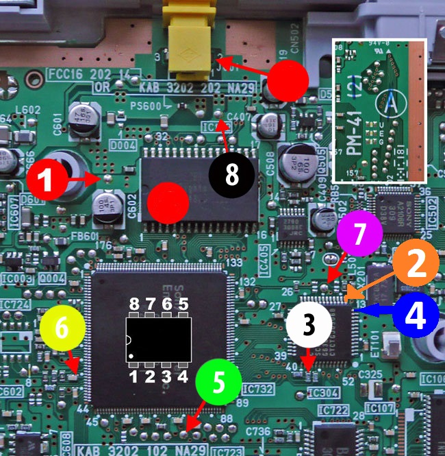

    Iirc Pal PSone needs onechip
    Here is one of my diagrams I made..
    I have blank or pre programmed ic in stock if you are in Australia or NewZealand

    mm3 only needs 6 wires for the pm-41 (2) motherboards

    Are there any alternative solder points for 2 and 4? For Mayumi4.0
    What are the benefits of OneChip? Solder points are different, arent they?
