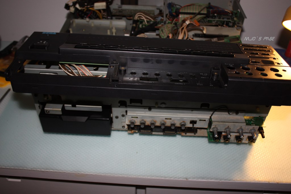

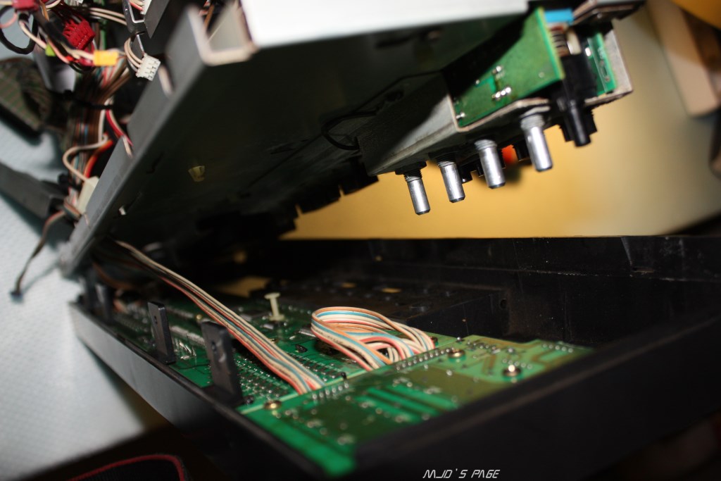

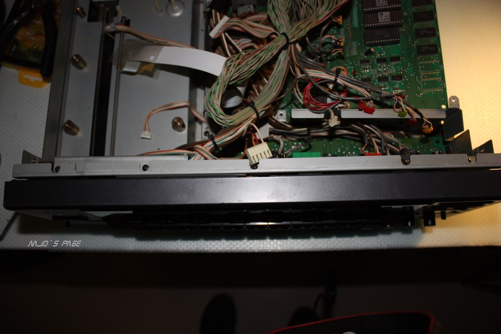

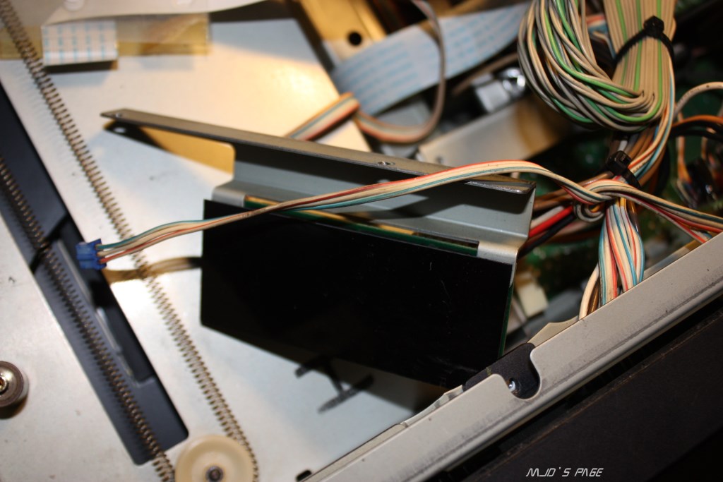

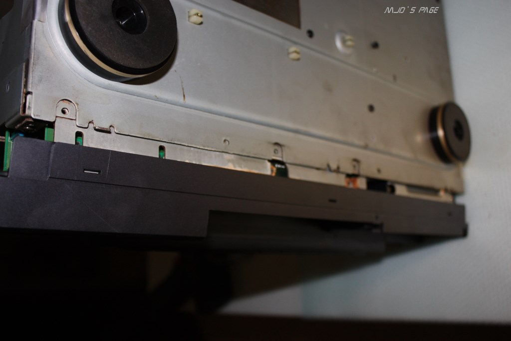

    If it interests someone, I've made for the SEGA Super Prologue 21one post in another forum presenting, working manual, disassembling, reparing etc... with lot of pictures. >>> In French sorry ^-^.

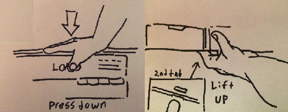

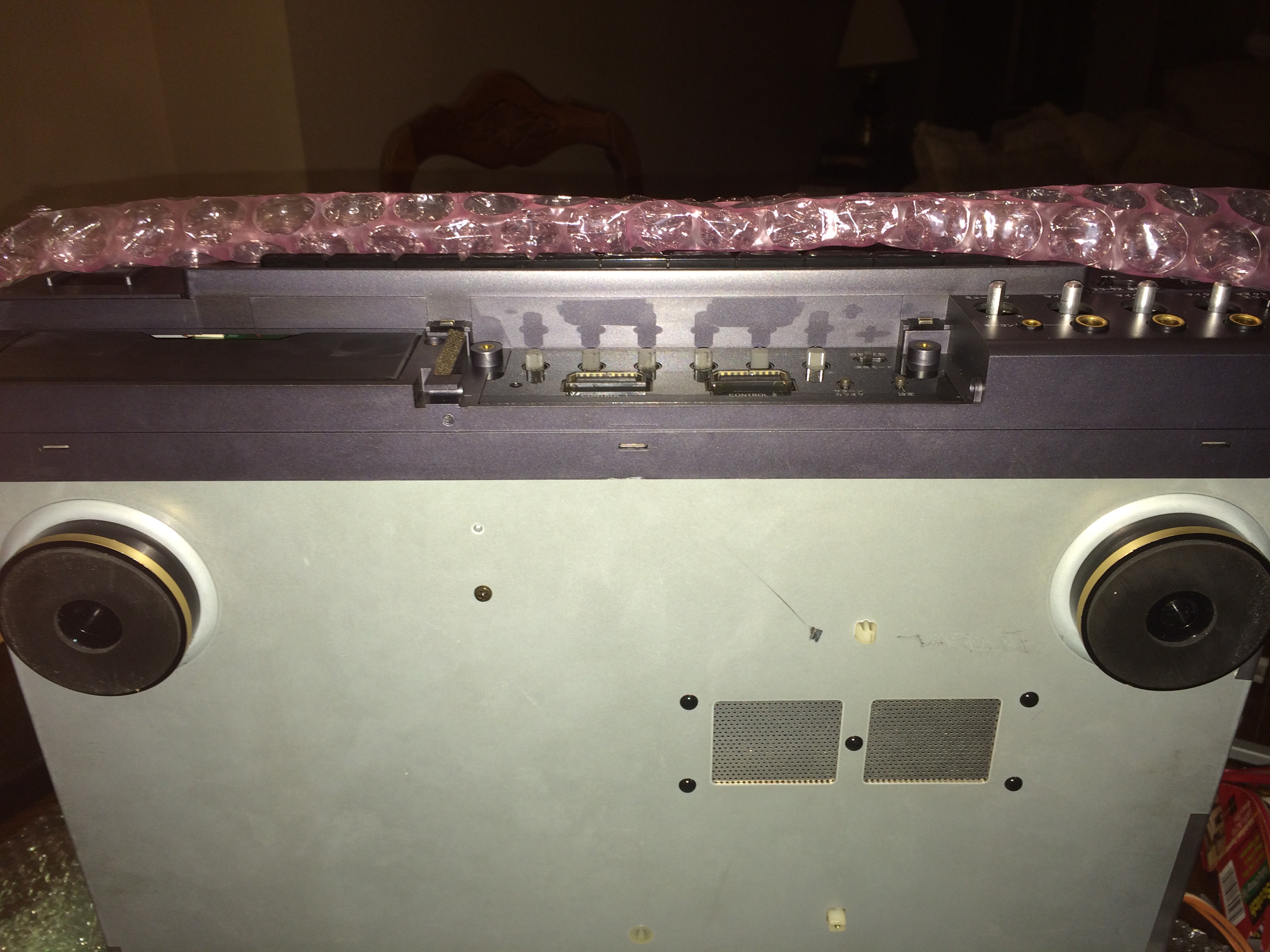

    I have a question gorefestor
    Do I have to put a lot of force or should they just slide right off?
    I tried for a good 30 minutes and could not get the front faceplate off
    Thanks
  6. GOREFESTOR
    GOREFESTOR Rising Member
    Dec 22, 2010
    69
    40
    Hello, Very simple, follow pictures.
    Only screws.
    Regards

    Ok I figured it out
    For future SKC 1000 owners press down on the top of the faceplate and get under neath with your finger while applying a good amount of force on the top to get the metal tabs out of the plastic channels underneath especially the second one.
    I made a picture for the more visual learners
    It does require a bit of wiggling and force
    Thanks gorefestor :)

    Exelent explaination and well made draw !!
