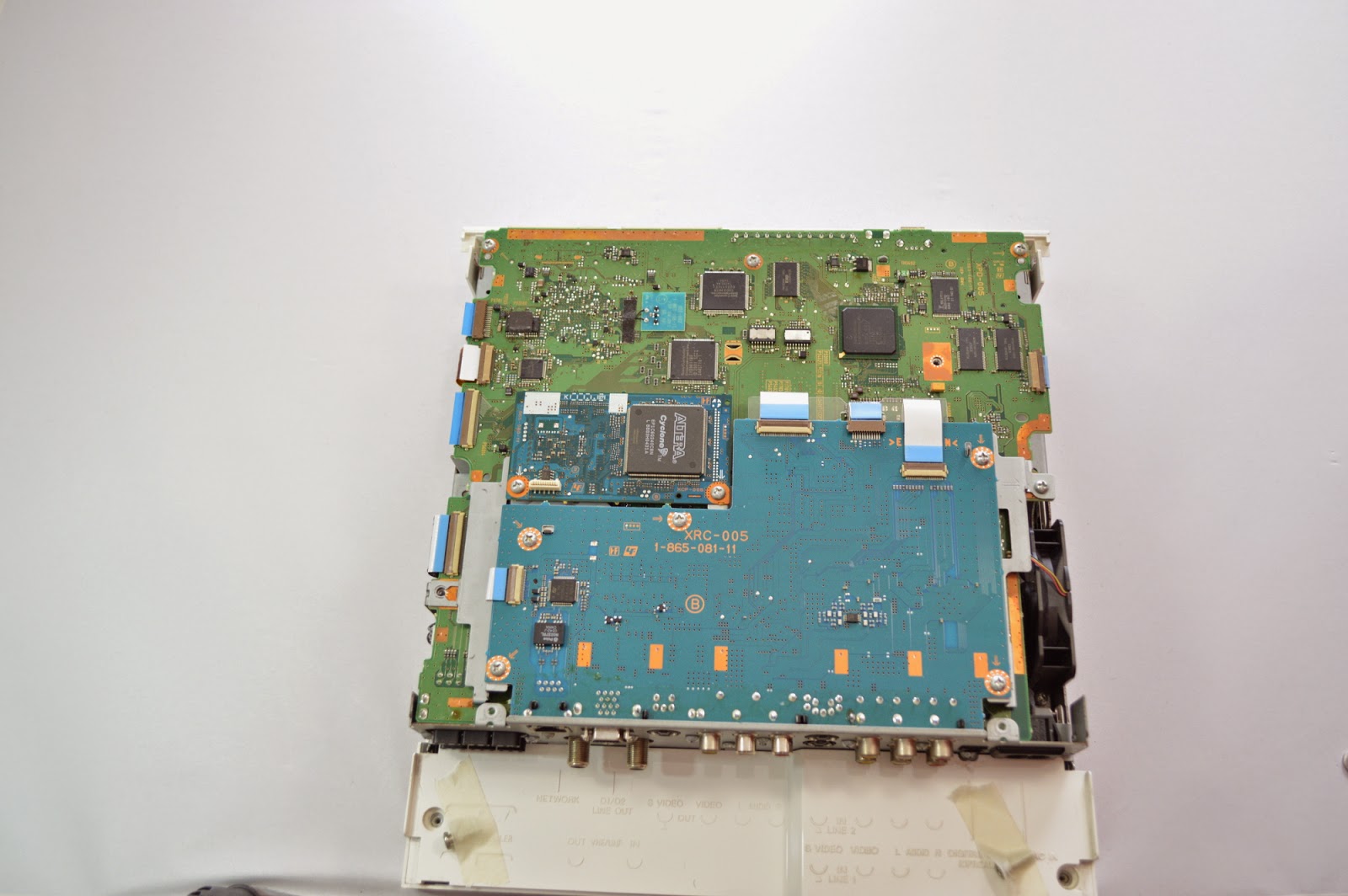

    Opening the PSX is slightly different for each model, it's not too hard to figure out (I am in the process of writing a teardown).
    Once you have the system open, locate the area of the D-Terminal, we are going to be soldering to the legs of the connector.

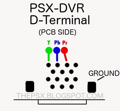

    Step 2: Pinouts​
    The PSX Supports Component already so all we need to do is tap into those connections..

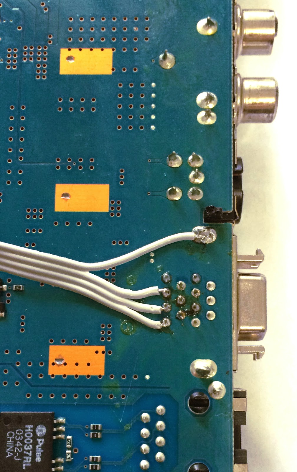

    Step 3: Solder In
    Now just solder in the four wires, run them to a connection of your choosing (RGB RCA connectors or a nice discreet 3.5mm TRRS headphone jack).
    Sit back and enjoy the pixels!

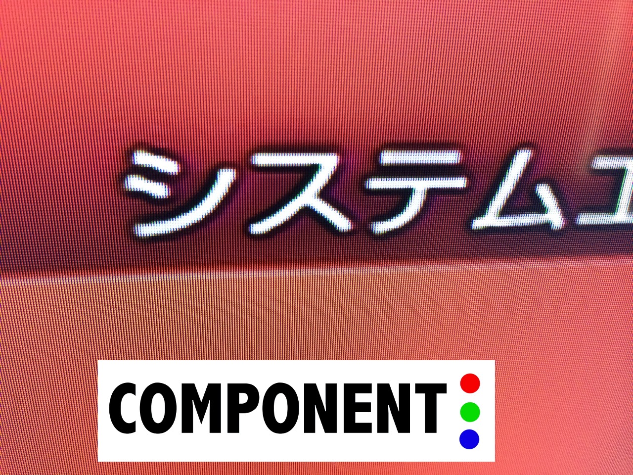

    Image after, The PSX, Over Component, outputs at 480i.
