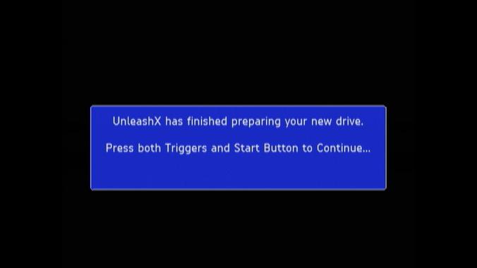

    Everything looks like it's working when I initially boot up. UnleashX detects a new hard drive and asks me if I want to format and I say yes using both triggers and start and it walks me through the process. It asks if I have F: drive and since I'm using a 500GB drive I say yes to do that.
    After it completes and I hold both triggers and start which should return me to the menu it starts UnleashX new hard drive detected process again.
    Except the second time around that I go through the process it seems to lock up or become unresponsive when I press both triggers and start at the "UnleashX has finished preparing your new hard drive"
    at this screen :
    Any ideas? Is my adapter compatible?
    The only thing I have not tried yet is using a 80 IDE connector instead of the stock 40 pin
    I get the same results with 2 different hard drives I have used (1TB Hitachi and 500GB Samsung)

    Yes, try the 80-wire.
    If it still doesn't work, try another bios that supports a "live config" file.
