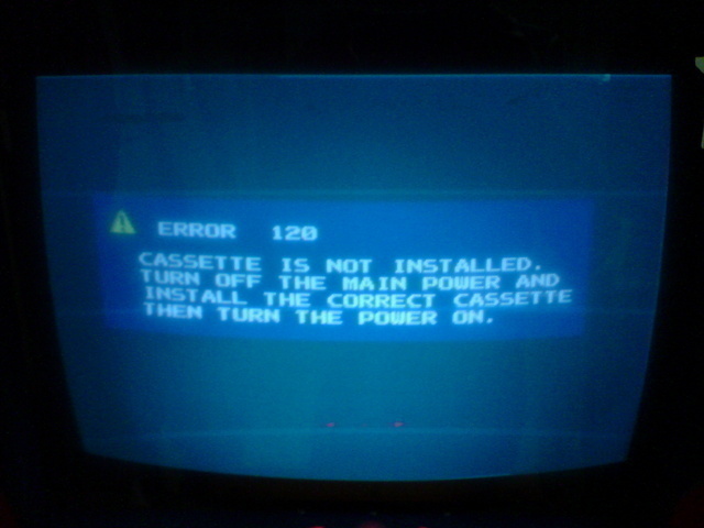

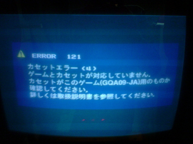

    Okay, I now have the Punch Mania 2 CD. I changed the dip switch to run off the CD rather than the flash card and booted it up, firstly without a security cartridge and then with the Fighting Mania cartridge.
    No cartridge:
    With Fighting Mania cartridge:
    So it would seem the Fighting Mania cartridge won't cut it, I'm going to need a Punch Mania 2 cartridge for the job... :banghead:

    The game uses a PCMCIA multiplexer iirc that connects two cards to one slot with the 3rd card in its own slot. There's no region locking on the 573, but the security cartridge is locked to the original 573 that the game was installed on. 573 security is fairly weak for the most part, and most hacked versions of games required maybe 2-3 instructions to be modified to bypass the cartridge check if you compare the files on the disc.
