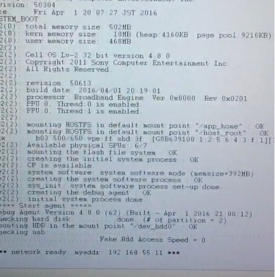

  6. HI_Ricky
    HI_Ricky Intrepid Member
    Jun 7, 2007
    650
    187
    no , CEX can not do GECR, like CEX can not do real DEX
    only DECR can set boot Arcade mode ;)
    if you own DECR, try switch to Arcade mode check it on TM log, you will know what up ;)
    btw, will like this check USB when power on DECR:
    and it will auto load config file in HDD to fix network and Display output
    when start up SCEEXE000 , PS3AIO will need USB link to USJPCB
