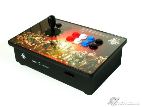

    My wife just bought me one of these sticks, it's supposed to be original XBOX and PS2 compatible, anyone know of a way to make it work with XBOX360?

    You're gonna need to buy a PS360+. The other way, if you are handy with a soldering iron is to follow a 360 padhacking guide (from an actual one with triggers or for simplicity's sake ANY of the Brawl Fight pads) and dual mod it so you can use it on three systems. If you had a PS3 instead, just get a usb adapter, though this being a Nubytech, compatibility maybe spotty.
    Actually, just did a search, you might get lucky with this adapter: http://www.dx.com/p/ps2-to-xbox-360-controller-adapter-cable-33241
    I would normally stick the PS2 standard due to the many adapters for it.

    Just took the bottom off the casing and the original PCB is gone and someone has made a half assed attempt to hack in a 360 pad PCB, everything just rattling around loose.
    Guess I have a project on my hands. PS360+ seems to be sold out everywhere.

    Maybe you can make your own ps360 ? I just got a Chinese ps2 to 360 converter. I can open it if you want and see what your dealing with
  8. Mechagouki
    Aug 18, 2013
    353
    That's kind of you, but my soldering ability is at the basic modchip installation level, I doubt I could put together a circuit board.
    I've cleaned up the inside of he unit a little, I'll take a better look at the 360 pcb later, but it's different to any images I can find on line.
    One thging - if I go the pad-hack route, do I need to keep the common grounds inside the stick, or will the commons on the pcb deal with all that?
