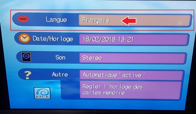

    Change language doesn't work.
    Need to boot original Bios SEGA,and change language in Setting.
    I asked Megavolt and Japanese_Cake for a software in Dreamshell for change language,but for the moment no solution.
    Because when you have changed Bios for Dreamshell (so remove Sega bios),and you forget to change the language you need to flash bios again in "normal bios"..change language..and reflash in Dreamshell..so for the moment need to don't forget change language before !! :)

    All I had to do was going into the original bios and change the language to English from within the main dashboard :p
    Now my console is NTSC-U with English language again.
