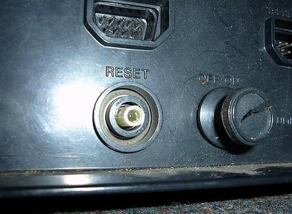

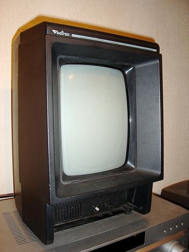

    I've been a long time stalker of this forum and now I finally got around to joining. This week I went to a local thrift store and managed to come across a Vectrex for only $5. When I asked for assistance the man told me he was going to buy it for his conversion van at the end of the day. I told him it wasn't a TV and he looked confused. :banghead:
    The unit turns on and the screen is bright. There is a humming noise, but I've found out this is common among the earlier models. It is missing a controller, which I'm sure I can pick up on eBay. The trickier part though is going to be finding replacement reset and volume knobs. I've attached two pics to this post.
    Are there any great resources out there for Vectrex owners that need replacement parts?

    Vectrex Buzz is common to almost all units at this point.
    The root cause is interference from the video hardware into the speaker cable.
    By design, there's a channel in the case along the "cleanest" route through the system. The speaker cable is taped into that channel, which greatly reduces the buzz.
    In the real world, tape doesn't hold for a quarter-century, and the cables are all flapping free.
    If you're feeling brave, you can open it and resecure the cable.
    But as someone that grew up on the Buzz, it seems wrong to fix it. :)

    Versions of Vectrex
    @JayBee
    The one I found has the GCE logo on it in the upper right hand corner. What was the model variant other than the Bandai one?
