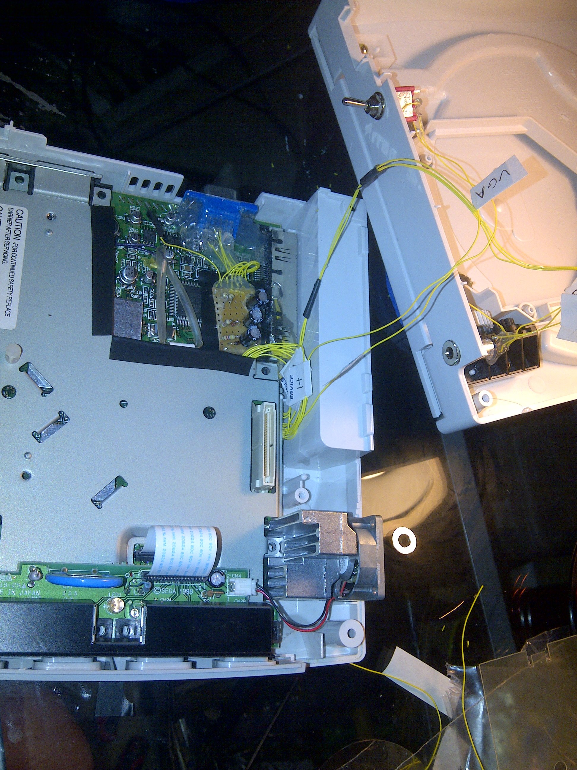

    I just finished up doing a VGA mod using the mmmonkey tutorial. I've never seen someone mount the vga connector using the method I chose so I figured i would post some pictures. It does require you cut some of the metal plate shielding, but it allows you to connect everything to the dreamcast motherboard as one unit. Anyways, what do you guys think?
    [​IMG][​IMG]

  2. Bad_Ad84
    1,309
    Not a fan of covering boards in hot glue.
  3. leetuser
    leetuser Rising Member
    Jul 6, 2012
    64
    lol, yeah, I wanted to mount it there and couldn't think of another option. I know I went overboard on the glue, but I don't think It will cause any problems. I kind of had to pile the glue on just so I could attach it solidly.

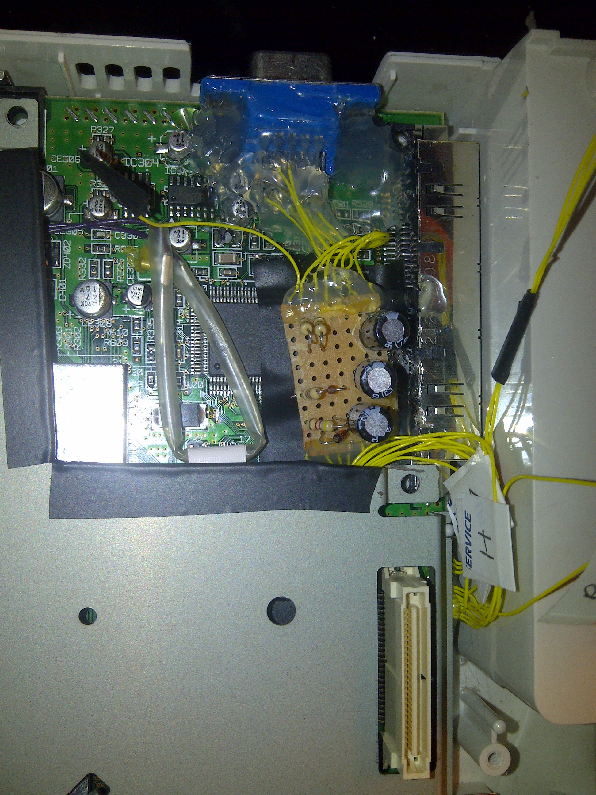

  4. leetuser
    Jul 6, 2012
    64
    Oh yeah. The only porblem with that location are the capacitors, they stick up just a little too much. I had to take the metal plate off of the GD rom drive and there's plenty of room. I'm not sure if it's necessary or not to keep that metal shield on it, but I'm going to remove those capacitors and mount them on a wire so I can lay them down flat.
  5. keropi
    keropi Familiar Face
    Feb 2, 2011
    1,068
    64
    I like the vga port placement... you could screw it on the case instead of using glue ... but in the end it works too :D
  6. Bad_Ad84
    1,309
    I agree, I like the placement too. But being upside down would annoy me (not got OCD, but it feels like it sometimes!)

  8. leetuser
    Jul 6, 2012
    64
    Haha, I know what you mean. The only reason the port is upside down is because the pins come off at a right angle at the other end and I had to bend them down so they wouldn't stick up so high. The one side of the port has a lot more plastic along it covering most of the lower pins which gave me a better surface to glue down.
  9. bacteria
    bacteria I am the Bacman
    Apr 8, 2008
    978
    Wires are quite long, would make sense to use shielded wires instead so as not to degrade the image quality or introduce interference.
