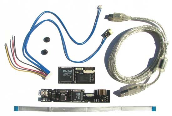

    The entire Viper GC Extreme is now installed.
    Only lack the programming software?
    Maybe these files will help!
