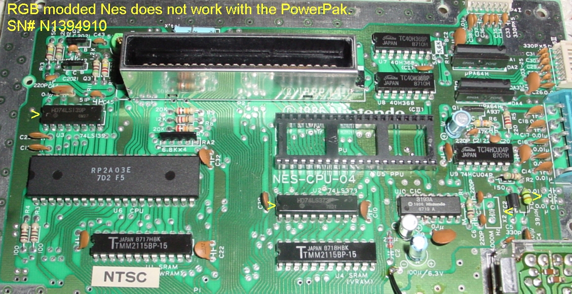

    Perhaps it doesn't work on your revision of the NES, just like Camerica carts had switches on the carts for different NES board revisions.

    A switch is the most straight forward way to make a multicart. Here the only game with actual production value is Super Contra which will contain a MMC3 clone, the rest are basic discrete games.
    Camerica games with a switch enable/disable the lockout ("10NES" according to Wikipedia n00bs) defeat circuit. It's necessary for top loaders which don't contain a CIC and I guess instead tie the signal to a power rail which would draw too much current and potentially damage stuff. All of these games should work on any NES with a proper 60->72 pin converter, all of which should have a CIC clone or defeat circuit.
    Having to cut the NES' lock CIC suggests that your converter's key CIC is broken.

    I call it "the CIC chip", AFAIK everyone did before a year or two ago. The algorithm/firmware is supposedly named 10NES (I think cited from Nintendo Power) but the chip designator is always CIC and physically inscribed 3193A, 6113B1 etc depending on the region and firmware revision.

    NES boards designated it CIC:
    http://farm6.static.flickr.com/5260/5416876611_73c9815dde.jpg
    http://www.greatlakesvista.com/rgb/nes/V4_nes_NonWorking.jpg
